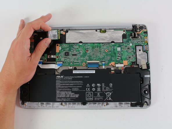

  5. ASUS Chromebook C200MA DS01 Wireless Card Replacement, Wireless Card: crwdns2935265:05crwdnd2935265:01crwdnd2935265:01crwdne2935265:0
    • Remove the silver 2.8 mm Phillips #0 screw from the wireless card.
  6. ASUS Chromebook C200MA DS01 Wireless Card Replacement: crwdns2935265:06crwdnd2935265:01crwdnd2935265:01crwdne2935265:0
    • Use a spudger to disconnect the white and black antenna cables connected to the wireless card.
  7. ASUS Chromebook C200MA DS01 Wireless Card Replacement: crwdns2935265:07crwdnd2935265:01crwdnd2935265:02crwdne2935265:0 ASUS Chromebook C200MA DS01 Wireless Card Replacement: crwdns2935265:07crwdnd2935265:02crwdnd2935265:02crwdne2935265:0
    • Grab the wireless card between your thumb and index finger and pull directly away from the motherboard.
