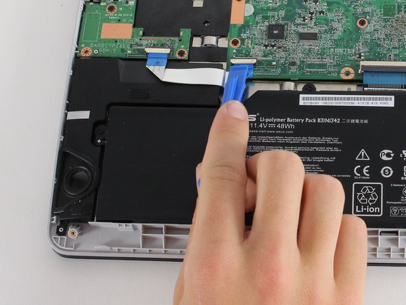

  4. ASUS Chromebook C200MA DS01 USB Board Replacement, Battery Connection: crwdns2935265:04crwdnd2935265:01crwdnd2935265:03crwdne2935265:0 ASUS Chromebook C200MA DS01 USB Board Replacement, Battery Connection: crwdns2935265:04crwdnd2935265:02crwdnd2935265:03crwdne2935265:0 ASUS Chromebook C200MA DS01 USB Board Replacement, Battery Connection: crwdns2935265:04crwdnd2935265:03crwdnd2935265:03crwdne2935265:0
    • To disconnect the battery, pinch the multi-color bundle cable with your thumb and forefinger and pull directly back.

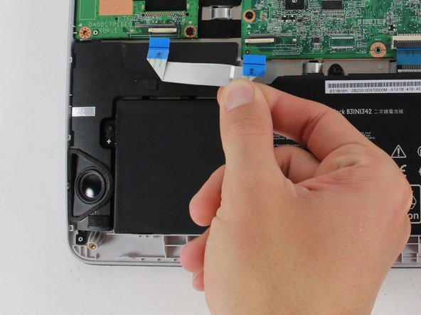

  5. ASUS Chromebook C200MA DS01 USB Board Replacement, USB Board: crwdns2935265:05crwdnd2935265:01crwdnd2935265:03crwdne2935265:0 ASUS Chromebook C200MA DS01 USB Board Replacement, USB Board: crwdns2935265:05crwdnd2935265:02crwdnd2935265:03crwdne2935265:0 ASUS Chromebook C200MA DS01 USB Board Replacement, USB Board: crwdns2935265:05crwdnd2935265:03crwdnd2935265:03crwdne2935265:0
    • Disconnect the USB board ZIF (zero insertion force) connectors which connect the motherboard to the USB board in the upper left.
    • Flip the ZIF retaining flaps up using a plastic opening tool or your fingers.
    • Pull gently on the ribbon cable to disconnect it from the sockets.
