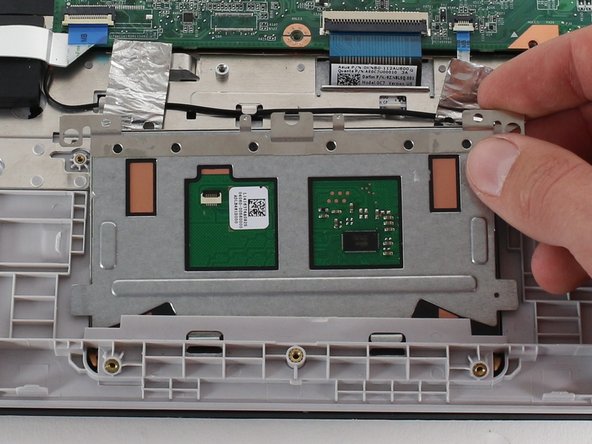

  7. ASUS Chromebook C200MA DS01 Touchpad Replacement, Touchpad: crwdns2935265:07crwdnd2935265:01crwdnd2935265:01crwdne2935265:0
    • Locate the touchpad.
    • Locate the touch pad cable connector.

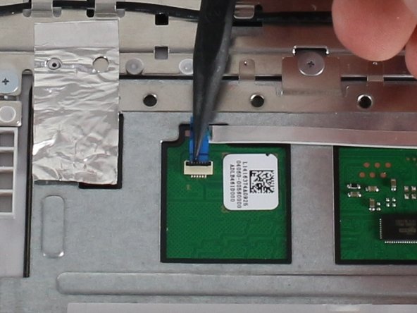

  8. ASUS Chromebook C200MA DS01 Touchpad Replacement: crwdns2935265:08crwdnd2935265:01crwdnd2935265:03crwdne2935265:0 ASUS Chromebook C200MA DS01 Touchpad Replacement: crwdns2935265:08crwdnd2935265:02crwdnd2935265:03crwdne2935265:0 ASUS Chromebook C200MA DS01 Touchpad Replacement: crwdns2935265:08crwdnd2935265:03crwdnd2935265:03crwdne2935265:0
    • Disconnect the touch pad ZIF(zero insertion force) connector.
    • Flip the flap up using a spudger or your fingers.
    • Pull gently on the ribbon cable to disconnect.

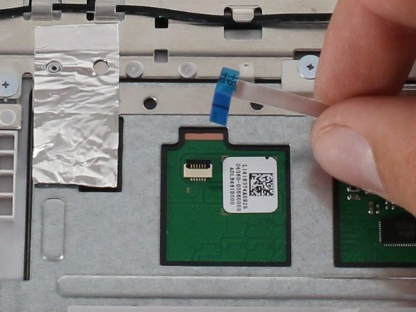

  9. ASUS Chromebook C200MA DS01 Touchpad Replacement: crwdns2935265:09crwdnd2935265:01crwdnd2935265:01crwdne2935265:0
    • Gently remove the adhesive on the touch pad ribbon cable.
  10. ASUS Chromebook C200MA DS01 Touchpad Replacement: crwdns2935265:010crwdnd2935265:01crwdnd2935265:03crwdne2935265:0 ASUS Chromebook C200MA DS01 Touchpad Replacement: crwdns2935265:010crwdnd2935265:02crwdnd2935265:03crwdne2935265:0 ASUS Chromebook C200MA DS01 Touchpad Replacement: crwdns2935265:010crwdnd2935265:03crwdnd2935265:03crwdne2935265:0
    • Gently remove the metallic tape from the touch pad only.
    • Try not to tear the tape, it can be re-used during reassembly.
  11. ASUS Chromebook C200MA DS01 Touchpad Replacement: crwdns2935265:011crwdnd2935265:01crwdnd2935265:01crwdne2935265:0
    • Remove the three 1.8 mm Phillips #00 screws.
  12. ASUS Chromebook C200MA DS01 Touchpad Replacement: crwdns2935265:012crwdnd2935265:01crwdnd2935265:02crwdne2935265:0 ASUS Chromebook C200MA DS01 Touchpad Replacement: crwdns2935265:012crwdnd2935265:02crwdnd2935265:02crwdne2935265:0
    • Lift the far edge of the touch pad to remove it.
