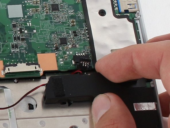

  7. ASUS Chromebook C200MA DS01 Speaker Replacement, Speaker: crwdns2935265:07crwdnd2935265:01crwdnd2935265:02crwdne2935265:0 ASUS Chromebook C200MA DS01 Speaker Replacement, Speaker: crwdns2935265:07crwdnd2935265:02crwdnd2935265:02crwdne2935265:0
    • Disconnect the speaker's black bundled cable connector on the motherboard.
    • The cables are red, white and black.
    • Pinch the black bundled cable connector between your thumb and pointer finger and pull.

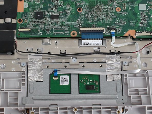

  8. ASUS Chromebook C200MA DS01 Speaker Replacement: crwdns2935265:08crwdnd2935265:01crwdnd2935265:02crwdne2935265:0 ASUS Chromebook C200MA DS01 Speaker Replacement: crwdns2935265:08crwdnd2935265:02crwdnd2935265:02crwdne2935265:0
    • Using your hands or the small plastic opening tool, pry the right speaker from the Chromebook.
    • There are small adhesives under the speakers that will provide moderate resistance.
  9. ASUS Chromebook C200MA DS01 Speaker Replacement: crwdns2935265:09crwdnd2935265:01crwdnd2935265:02crwdne2935265:0 ASUS Chromebook C200MA DS01 Speaker Replacement: crwdns2935265:09crwdnd2935265:02crwdnd2935265:02crwdne2935265:0
    • Disconnect the USB port ZIF(zero insertion force) connector that partially covers the left speaker.
    • Flip the ZIF retaining flap up using a spudger or your fingers.
    • Pull gently on the ribbon cable to remove it from the connector.
  10. ASUS Chromebook C200MA DS01 Speaker Replacement: crwdns2935265:010crwdnd2935265:01crwdnd2935265:02crwdne2935265:0 ASUS Chromebook C200MA DS01 Speaker Replacement: crwdns2935265:010crwdnd2935265:02crwdnd2935265:02crwdne2935265:0
    • Unravel the connecting cord between the two speakers.
  11. ASUS Chromebook C200MA DS01 Speaker Replacement: crwdns2935265:011crwdnd2935265:01crwdnd2935265:03crwdne2935265:0 ASUS Chromebook C200MA DS01 Speaker Replacement: crwdns2935265:011crwdnd2935265:02crwdnd2935265:03crwdne2935265:0 ASUS Chromebook C200MA DS01 Speaker Replacement: crwdns2935265:011crwdnd2935265:03crwdnd2935265:03crwdne2935265:0
    • Using the small plastic opening tool, pry the left speaker from the Chromebook.
    • Remove the speakers.
    • There are small adhesives that will provide moderate resistance.
