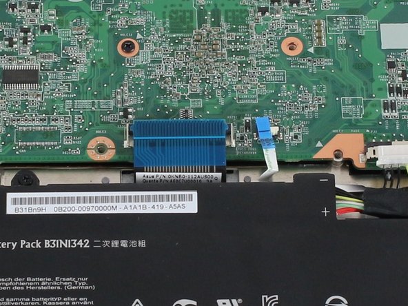

  5. ASUS Chromebook C200MA DS01 Motherboard Replacement, Motherboard: crwdns2935265:05crwdnd2935265:01crwdnd2935265:01crwdne2935265:0
    • Disconnect the USB board ZIF (zero insertion force) connector located towards the bottom left of the motherboard.
    • Flip the ZIF connector retaining flap up using either a spudger or your fingers.
    • Pull gently on the ribbon cable to disconnect it from the motherboard.

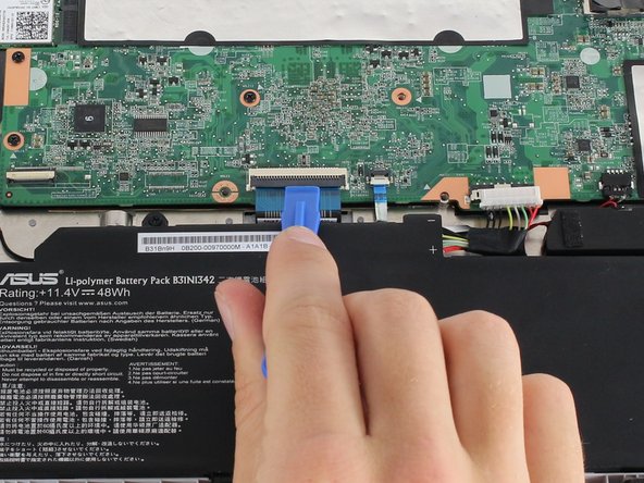

  6. ASUS Chromebook C200MA DS01 Motherboard Replacement: crwdns2935265:06crwdnd2935265:01crwdnd2935265:03crwdne2935265:0 ASUS Chromebook C200MA DS01 Motherboard Replacement: crwdns2935265:06crwdnd2935265:02crwdnd2935265:03crwdne2935265:0 ASUS Chromebook C200MA DS01 Motherboard Replacement: crwdns2935265:06crwdnd2935265:03crwdnd2935265:03crwdne2935265:0
    • Disconnect the large keyboard and small touchpad ZIF connectors, both located in the middle of the bottom edge of the motherboard.
    • Flip both ZIF retaining flaps up using either a spudger or your fingers.
    • Gently pull on each ribbon cable to disconnect them from the motherboard.

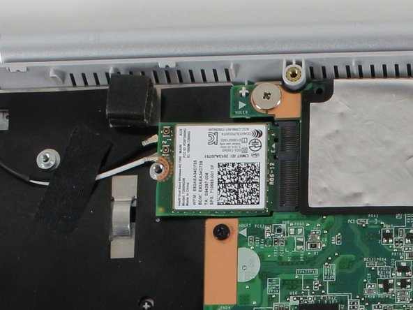

    • Disconnect the black and white antenna cable connectors for the WiFi card. The connectors look like small buttons on the ends of colored wires.
    • Gently pry the cable connectors off with your fingers or a spudger.
    • These connections are button-like and will have a little resistance when removing.
