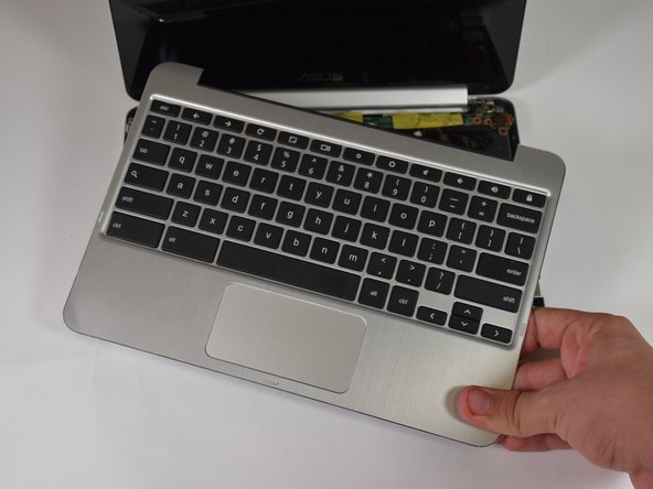

  6. ASUS Chromebook C100PA-RBRKT07 Trackpad Replacement, Trackpad: crwdns2935265:06crwdnd2935265:01crwdnd2935265:02crwdne2935265:0 ASUS Chromebook C100PA-RBRKT07 Trackpad Replacement, Trackpad: crwdns2935265:06crwdnd2935265:02crwdnd2935265:02crwdne2935265:0
    • Grip the keyboard and carefully pull it off the device.

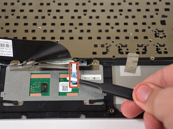

  7. ASUS Chromebook C100PA-RBRKT07 Trackpad Replacement: crwdns2935265:07crwdnd2935265:01crwdnd2935265:02crwdne2935265:0 ASUS Chromebook C100PA-RBRKT07 Trackpad Replacement: crwdns2935265:07crwdnd2935265:02crwdnd2935265:02crwdne2935265:0
    • On the back of the keyboard assembly, use the tweezers to pull the white cable from the track pad.

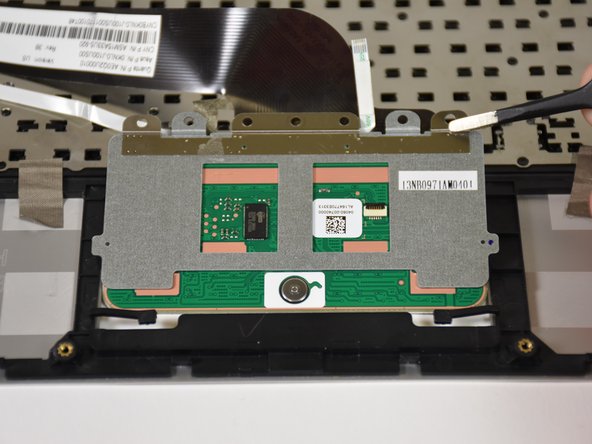

  8. ASUS Chromebook C100PA-RBRKT07 Trackpad Replacement: crwdns2935265:08crwdnd2935265:01crwdnd2935265:01crwdne2935265:0
    • Remove the three 1 mm screws from the track pad using the JIS 00 screwdriver.
  9. ASUS Chromebook C100PA-RBRKT07 Trackpad Replacement: crwdns2935265:09crwdnd2935265:01crwdnd2935265:02crwdne2935265:0 ASUS Chromebook C100PA-RBRKT07 Trackpad Replacement: crwdns2935265:09crwdnd2935265:02crwdnd2935265:02crwdne2935265:0
    • Grip the track pad with the tweezers and slide it up and out of the keyboard assembly.
