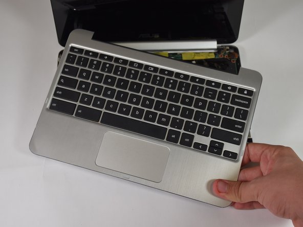

  4. ASUS Chromebook C100PA-RBRKT07 Keyboard Replacement: crwdns2935265:04crwdnd2935265:01crwdnd2935265:01crwdne2935265:0
    • Use the iFixit opening tool to remove the back of the laptop.
  5. ASUS Chromebook C100PA-RBRKT07 Keyboard Replacement: crwdns2935265:05crwdnd2935265:01crwdnd2935265:01crwdne2935265:0
    • Use the blunt nose tweezers to separate the keyboard from the internal components.
  6. ASUS Chromebook C100PA-RBRKT07 Keyboard Replacement, Keyboard: crwdns2935265:06crwdnd2935265:01crwdnd2935265:02crwdne2935265:0 ASUS Chromebook C100PA-RBRKT07 Keyboard Replacement, Keyboard: crwdns2935265:06crwdnd2935265:02crwdnd2935265:02crwdne2935265:0
    • Remove the keyboard from the laptop.
    • The Trackpad is attached to the keyboard assembly. The Trackpad replacement guide can be found on the ASUS Chromebook CPPA-RBRKT07 homepage.
