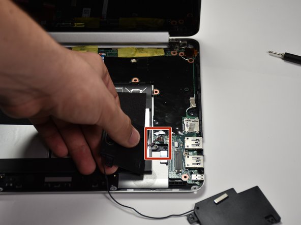

  6. ASUS Chromebook C100PA-RBRKT07 Battery Replacement: crwdns2935265:06crwdnd2935265:01crwdnd2935265:01crwdne2935265:0
    • Use the JIS1 screwdriver to remove the four 2.1 mm screws around the audio cards.
  7. ASUS Chromebook C100PA-RBRKT07 Battery Replacement: crwdns2935265:07crwdnd2935265:01crwdnd2935265:02crwdne2935265:0 ASUS Chromebook C100PA-RBRKT07 Battery Replacement: crwdns2935265:07crwdnd2935265:02crwdnd2935265:02crwdne2935265:0
    • Gently disconnect the audio cards, exposing the battery.
  8. ASUS Chromebook C100PA-RBRKT07 Battery Replacement: crwdns2935265:08crwdnd2935265:01crwdnd2935265:01crwdne2935265:0
    • Use the J00 screwdriver to remove the three 1.7 mm battery screws.
  9. ASUS Chromebook C100PA-RBRKT07 Battery Replacement: crwdns2935265:09crwdnd2935265:01crwdnd2935265:03crwdne2935265:0 ASUS Chromebook C100PA-RBRKT07 Battery Replacement: crwdns2935265:09crwdnd2935265:02crwdnd2935265:03crwdne2935265:0 ASUS Chromebook C100PA-RBRKT07 Battery Replacement: crwdns2935265:09crwdnd2935265:03crwdnd2935265:03crwdne2935265:0
    • Grip the battery and remove it from the device.
    • Remove the battery cable out of the motherboard by lifting the battery cables.
