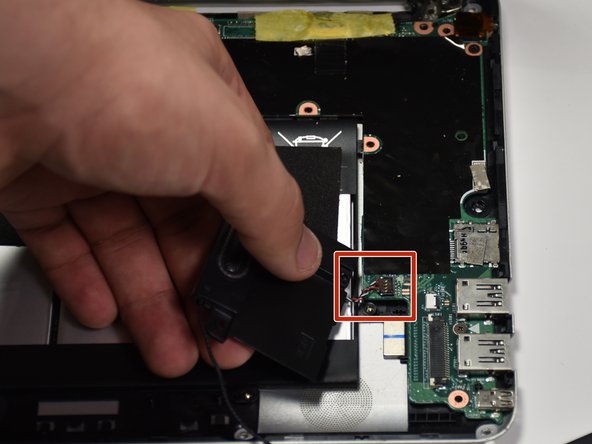

  6. ASUS Chromebook C100PA-RBRKT07 Audio Ports Replacement, Audio Ports: crwdns2935265:06crwdnd2935265:01crwdnd2935265:01crwdne2935265:0
    • Remove the four 3mm J1 screws attached to the audio cards.
  7. ASUS Chromebook C100PA-RBRKT07 Audio Ports Replacement: crwdns2935265:07crwdnd2935265:01crwdnd2935265:02crwdne2935265:0 ASUS Chromebook C100PA-RBRKT07 Audio Ports Replacement: crwdns2935265:07crwdnd2935265:02crwdnd2935265:02crwdne2935265:0
    • Lift and remove the audio cards.
    • Separate the wires from the motherboard.
