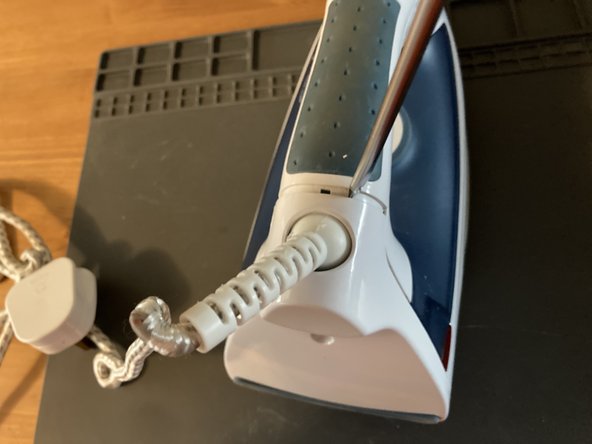

  1. ASDA ES177 Steam Iron Power cord Replacement, Disassembly: crwdns2935265:01crwdnd2935265:01crwdnd2935265:03crwdne2935265:0 ASDA ES177 Steam Iron Power cord Replacement, Disassembly: crwdns2935265:01crwdnd2935265:02crwdnd2935265:03crwdne2935265:0 ASDA ES177 Steam Iron Power cord Replacement, Disassembly: crwdns2935265:01crwdnd2935265:03crwdnd2935265:03crwdne2935265:0
    • Remove the security screw from the back panel.
    • Be cautious of any residual charge when disassembling.

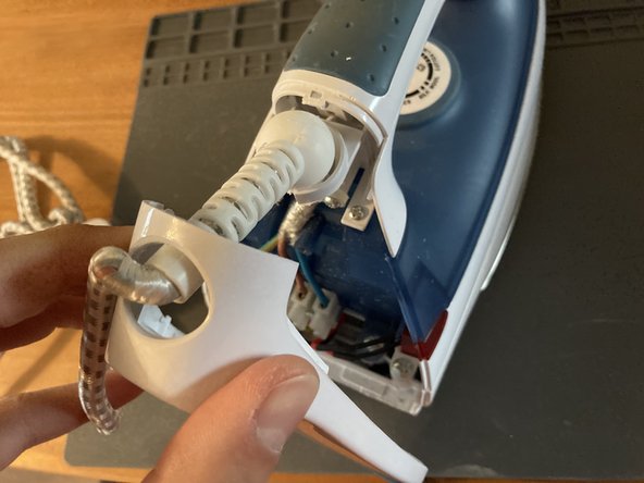

  2. ASDA ES177 Steam Iron Power cord Replacement, Remove the back plate: crwdns2935265:02crwdnd2935265:01crwdnd2935265:03crwdne2935265:0 ASDA ES177 Steam Iron Power cord Replacement, Remove the back plate: crwdns2935265:02crwdnd2935265:02crwdnd2935265:03crwdne2935265:0 ASDA ES177 Steam Iron Power cord Replacement, Remove the back plate: crwdns2935265:02crwdnd2935265:03crwdnd2935265:03crwdne2935265:0
    • Insert a flathead screwdriver to pop off the back plate
  3. ASDA ES177 Steam Iron Power cord Replacement, Remove the cord from the holder: crwdns2935265:03crwdnd2935265:01crwdnd2935265:03crwdne2935265:0 ASDA ES177 Steam Iron Power cord Replacement, Remove the cord from the holder: crwdns2935265:03crwdnd2935265:02crwdnd2935265:03crwdne2935265:0 ASDA ES177 Steam Iron Power cord Replacement, Remove the cord from the holder: crwdns2935265:03crwdnd2935265:03crwdnd2935265:03crwdne2935265:0
    • Remove the retainer clamp by unscrewing the two Phillips screws.

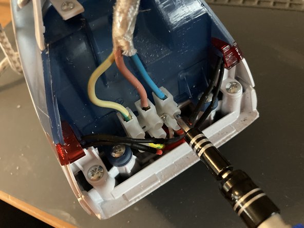

  4. ASDA ES177 Steam Iron Power cord Replacement, Release the cord from the connector: crwdns2935265:04crwdnd2935265:01crwdnd2935265:03crwdne2935265:0 ASDA ES177 Steam Iron Power cord Replacement, Release the cord from the connector: crwdns2935265:04crwdnd2935265:02crwdnd2935265:03crwdne2935265:0 ASDA ES177 Steam Iron Power cord Replacement, Release the cord from the connector: crwdns2935265:04crwdnd2935265:03crwdnd2935265:03crwdne2935265:0
    • Remove the three flat-headed screws from the connector

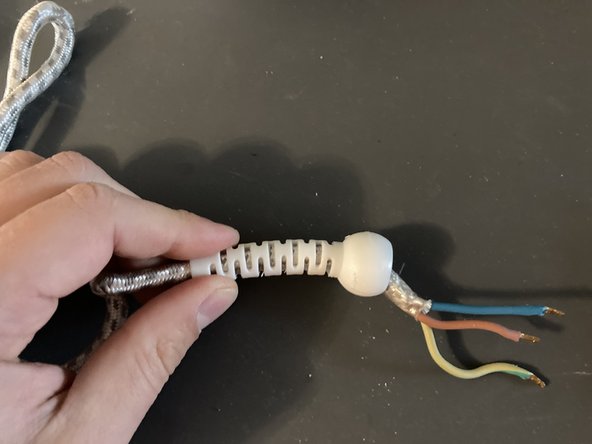

  5. ASDA ES177 Steam Iron Power cord Replacement, Remove the plug: crwdns2935265:05crwdnd2935265:01crwdnd2935265:03crwdne2935265:0 ASDA ES177 Steam Iron Power cord Replacement, Remove the plug: crwdns2935265:05crwdnd2935265:02crwdnd2935265:03crwdne2935265:0 ASDA ES177 Steam Iron Power cord Replacement, Remove the plug: crwdns2935265:05crwdnd2935265:03crwdnd2935265:03crwdne2935265:0
    • Unscrew the main screw to reveal the 3-core cable.
    • Remove the two screws that retain the cord in the plug.
