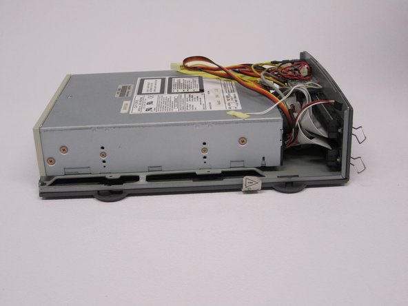

  4. APS Tech 101629 SCSI Connections Replacement: crwdns2935265:04crwdnd2935265:01crwdnd2935265:01crwdne2935265:0
    • Flip device upside down again.
    • Gently pry the bottom gray casing away from the device.

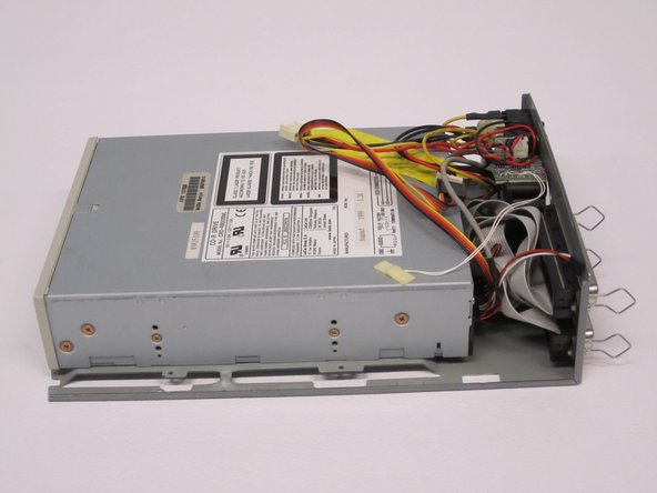

  5. APS Tech 101629 SCSI Connections Replacement: crwdns2935265:05crwdnd2935265:01crwdnd2935265:02crwdne2935265:0 APS Tech 101629 SCSI Connections Replacement: crwdns2935265:05crwdnd2935265:02crwdnd2935265:02crwdne2935265:0
    • Rotate so the back of the device is facing you.
    • Gently pry the back casing away.
    • When the back casing is removed, the fan will become loose.

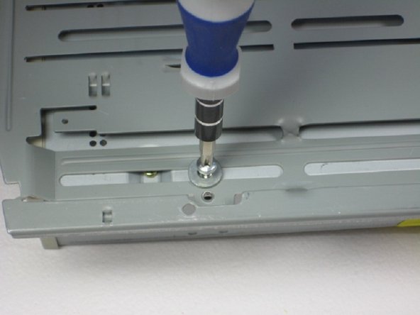

  6. APS Tech 101629 SCSI Connections Replacement, Internal Drive Component: crwdns2935265:06crwdnd2935265:01crwdnd2935265:02crwdne2935265:0 APS Tech 101629 SCSI Connections Replacement, Internal Drive Component: crwdns2935265:06crwdnd2935265:02crwdnd2935265:02crwdne2935265:0
    • Flip so device is upside down.
    • Remove 4 screws with Phillips #1 screw driver.
    • Be sure to save the washers that seperate the screws from the baseplate for reassembly.

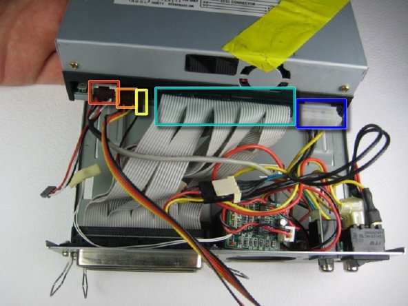

  7. APS Tech 101629 SCSI Connections Replacement: crwdns2935265:07crwdnd2935265:01crwdnd2935265:02crwdne2935265:0 APS Tech 101629 SCSI Connections Replacement: crwdns2935265:07crwdnd2935265:02crwdnd2935265:02crwdne2935265:0
    • Slide the internal drive component away from the back of the device.
    • Remove the connections from the back of the internal component in the order of your choosing, we suggest left to right. The connections are:
    • Audio Connection
    • SCSI ID
    • Terminate On
    • SCSI Connection
    • DC Input (power)

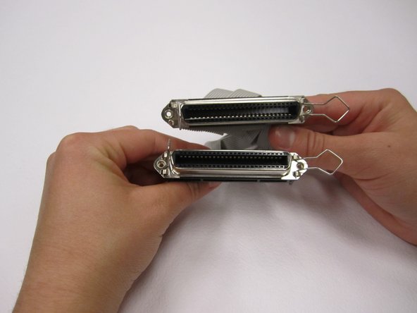

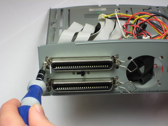

  8. APS Tech 101629 SCSI Connections Replacement, SCSI Connections: crwdns2935265:08crwdnd2935265:01crwdnd2935265:03crwdne2935265:0 APS Tech 101629 SCSI Connections Replacement, SCSI Connections: crwdns2935265:08crwdnd2935265:02crwdnd2935265:03crwdne2935265:0 APS Tech 101629 SCSI Connections Replacement, SCSI Connections: crwdns2935265:08crwdnd2935265:03crwdnd2935265:03crwdne2935265:0
    • Remove the four Phillips #1 Screws from back panel.
    • Once the screws are removed, the two connections are easily removed from the body.
