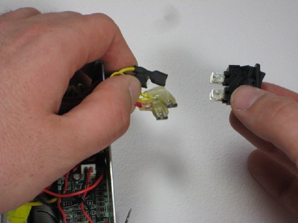

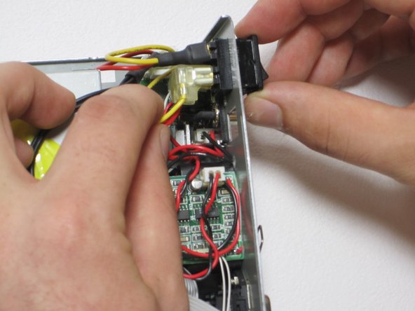

    1. APS Tech 101629 Power Switch Replacement, Power Switch: crwdns2935265:08crwdnd2935265:01crwdnd2935265:02crwdne2935265:0 APS Tech 101629 Power Switch Replacement, Power Switch: crwdns2935265:08crwdnd2935265:02crwdnd2935265:02crwdne2935265:0
      • Depress 2 pressure holds on each side of the power switch.
      • Press out the back of the device.
    2. APS Tech 101629 Power Switch Replacement: crwdns2935265:09crwdnd2935265:01crwdnd2935265:02crwdne2935265:0 APS Tech 101629 Power Switch Replacement: crwdns2935265:09crwdnd2935265:02crwdnd2935265:02crwdne2935265:0
      • Remove all four 4 connections from the power switch.
      • Remember that the straight connections are on the far side, while the L-shaped connections are on the near side, and that both yellow connections are on top. This is helpful for reassembly.
      • These are very hard to get off, use patience and wiggling.
