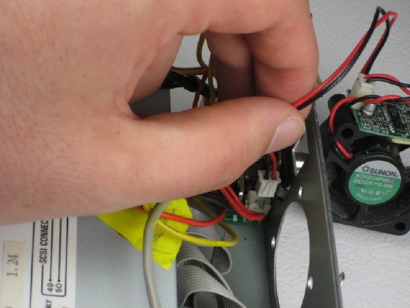

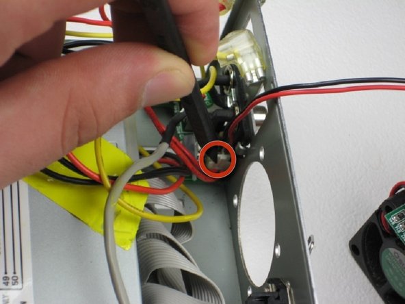

  10. APS Tech 101629 Exhaust Fan Replacement, Exhaust Fan: crwdns2935265:010crwdnd2935265:01crwdnd2935265:01crwdne2935265:0
    • Remove temperature guage.
  11. APS Tech 101629 Exhaust Fan Replacement: crwdns2935265:011crwdnd2935265:01crwdnd2935265:03crwdne2935265:0 APS Tech 101629 Exhaust Fan Replacement: crwdns2935265:011crwdnd2935265:02crwdnd2935265:03crwdne2935265:0 APS Tech 101629 Exhaust Fan Replacement: crwdns2935265:011crwdnd2935265:03crwdnd2935265:03crwdne2935265:0
    • Move the exhaust fan out of the way so you can access its control cord.
    • Use the spudger to depress the hold on the fan cord.
    • Gently pull fan cord from connection and remove fan completely.
