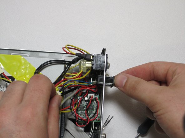

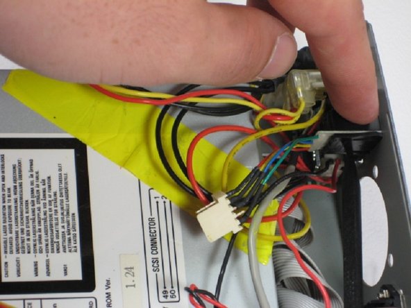

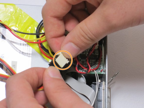

  6. APS Tech 101629 Channel Switch Replacement, Channel Switch: crwdns2935265:06crwdnd2935265:01crwdnd2935265:02crwdne2935265:0 APS Tech 101629 Channel Switch Replacement, Channel Switch: crwdns2935265:06crwdnd2935265:02crwdnd2935265:02crwdne2935265:0
    • Find the conjoined ID cable wires that are colored black, orange, and yellow.
    • Lift white portion of cable wires to disconnect it.
