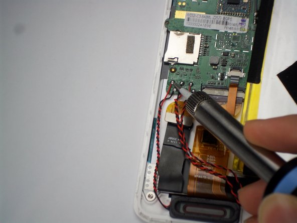

  6. APEX TM785CH Circuit Board Replacement: crwdns2935265:06crwdnd2935265:01crwdnd2935265:02crwdne2935265:0 APEX TM785CH Circuit Board Replacement: crwdns2935265:06crwdnd2935265:02crwdnd2935265:02crwdne2935265:0
    • You will need a soldering/desoldering kit to desolder the 4 leads where the speakers connect to the circuit board.

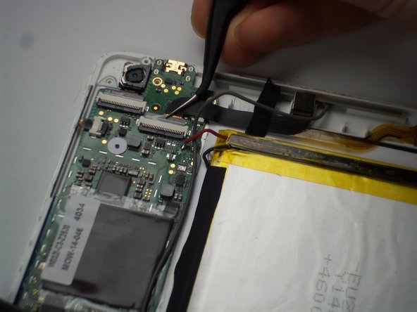

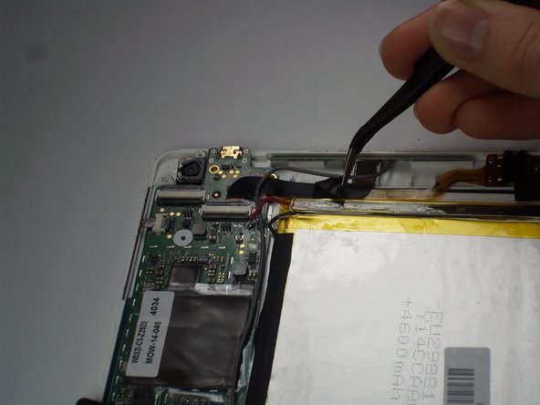

    • First, use plastic coated tweezers to pull up the black release tab.
    • Pull on the black connector with tweezers as close as possible to the white connector base, making sure not to pull on the connector base.
    • It is important to be careful not to damage the black connector tape or the white base.
    • Next, use the tweezers to peel off the tape holding down the connector to the front camera.
    • The front camera can now be removed from its socket.

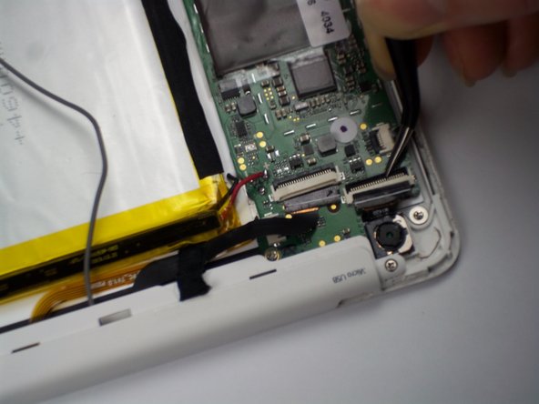

  10. APEX TM785CH Circuit Board Replacement, Circuit Board: crwdns2935265:010crwdnd2935265:01crwdnd2935265:03crwdne2935265:0 APEX TM785CH Circuit Board Replacement, Circuit Board: crwdns2935265:010crwdnd2935265:02crwdnd2935265:03crwdne2935265:0 APEX TM785CH Circuit Board Replacement, Circuit Board: crwdns2935265:010crwdnd2935265:03crwdnd2935265:03crwdne2935265:0
    • After removing the top panel, battery, speakers, microphone, and front camera from the tablet, you will also need to use the tweezers to remove the connectors indicated in the same method as the previous step.

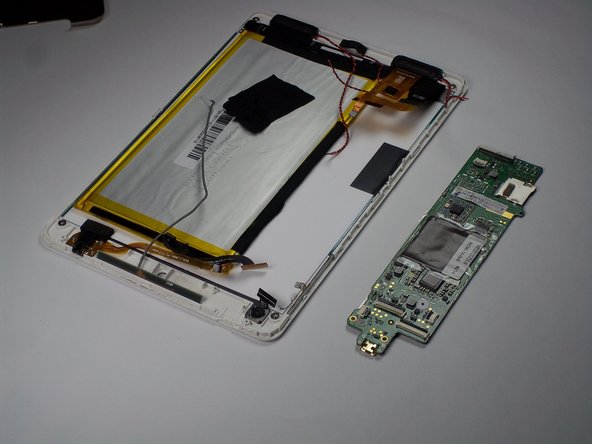

  11. APEX TM785CH Circuit Board Replacement: crwdns2935265:011crwdnd2935265:01crwdnd2935265:02crwdne2935265:0 APEX TM785CH Circuit Board Replacement: crwdns2935265:011crwdnd2935265:02crwdnd2935265:02crwdne2935265:0
    • Using a Phillips screwdriver, remove three 2.25 mm screws from the circuit board.
    • The circuit board can now be removed from the tablet.
