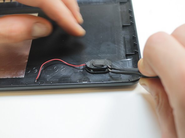

    • Carefully place the bottom lid next to the screen case. The power/speaker buttons should be visible at the corner of the lid. Remove the buttons with the tweezers.
  4. APEX AP-GS918 Speakers Replacement, Speakers: crwdns2935265:04crwdnd2935265:01crwdnd2935265:03crwdne2935265:0 APEX AP-GS918 Speakers Replacement, Speakers: crwdns2935265:04crwdnd2935265:02crwdnd2935265:03crwdne2935265:0 APEX AP-GS918 Speakers Replacement, Speakers: crwdns2935265:04crwdnd2935265:03crwdnd2935265:03crwdne2935265:0
    • The speaker is attached to the bottom lid with with a small amount of glue and the wires are soldered to the motherboard.

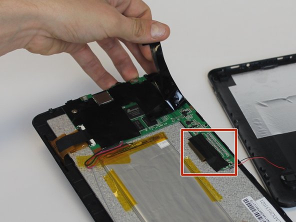

    • Start by peeling back the black electrical tape covering the motherboard components
    • You will also need to remove the black cloth tape covering the wire contact points.

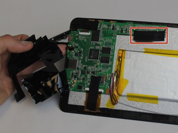

  5. APEX AP-GS918 Speakers Replacement: crwdns2935265:05crwdnd2935265:01crwdnd2935265:02crwdne2935265:0 APEX AP-GS918 Speakers Replacement: crwdns2935265:05crwdnd2935265:02crwdnd2935265:02crwdne2935265:0
    • Now that the contacts are exposed, you can desolder them.
    • Make sure to allow ample time (at least 5-8 minutes or more) for the soldering iron to heat up. Otherwise, the solder won't melt.
    • Touch the hot iron to the contact points and gently pull on the wires to loosen them from the solder. They should release easily.
    • Make sure not to touch the contact points after desoldering them because they will remain very hot for a short while afterwards.
    • The speaker can now be removed. You may need to pull it with some force since there is a small bead of hot glue holding the speaker to its housing
