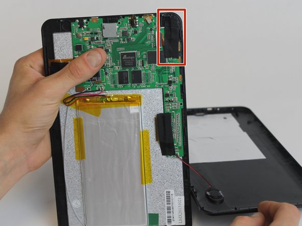

  3. APEX AP-GS918 Camera Replacement: crwdns2935265:03crwdnd2935265:01crwdnd2935265:02crwdne2935265:0 APEX AP-GS918 Camera Replacement: crwdns2935265:03crwdnd2935265:02crwdnd2935265:02crwdne2935265:0
    • Carefully place the bottom lid next to the screen case. The power/speaker buttons should be visible at the corner of the lid. Remove the buttons with the tweezers.

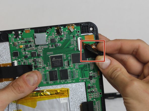

  4. APEX AP-GS918 Camera Replacement, Camera: crwdns2935265:04crwdnd2935265:01crwdnd2935265:03crwdne2935265:0 APEX AP-GS918 Camera Replacement, Camera: crwdns2935265:04crwdnd2935265:02crwdnd2935265:03crwdne2935265:0 APEX AP-GS918 Camera Replacement, Camera: crwdns2935265:04crwdnd2935265:03crwdnd2935265:03crwdne2935265:0
    • Remove the black electrical tape covering the motherboard components along with the black cloth tape covering the camera itself.
    • Be careful when removing the black cloth tape from the camera on the top left corner of the tablet. The tape will likely stick and pull the camera with it.

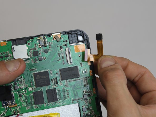

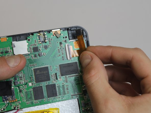

  5. APEX AP-GS918 Camera Replacement: crwdns2935265:05crwdnd2935265:01crwdnd2935265:03crwdne2935265:0 APEX AP-GS918 Camera Replacement: crwdns2935265:05crwdnd2935265:02crwdnd2935265:03crwdne2935265:0 APEX AP-GS918 Camera Replacement: crwdns2935265:05crwdnd2935265:03crwdnd2935265:03crwdne2935265:0
    • Locate the white and gray connector that's holding the camera in place.
    • Use the black nylon spudger to eject the camera from its slot by gently lifting the gray clip vertically 90°.
    • Once ejected, you may easily remove the camera by pulling it from its slot.
