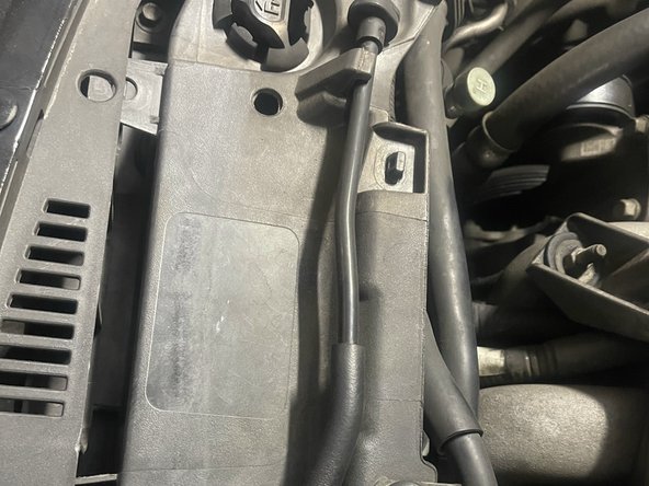

  2. ANY CAR  spark plugs and ignition/coil pack  Replacement, remove plastic and exposing the top of engine: crwdns2935265:02crwdnd2935265:01crwdnd2935265:01crwdne2935265:0
    • *This may not be applicable to all cars* You will have to examine the cover and look for any tabs that are used to keep it in place. If any are used, you will use your flat head and carefully pry the tab off. Once all the tabs are off you will be able to finally lift and remove the engine cover.
