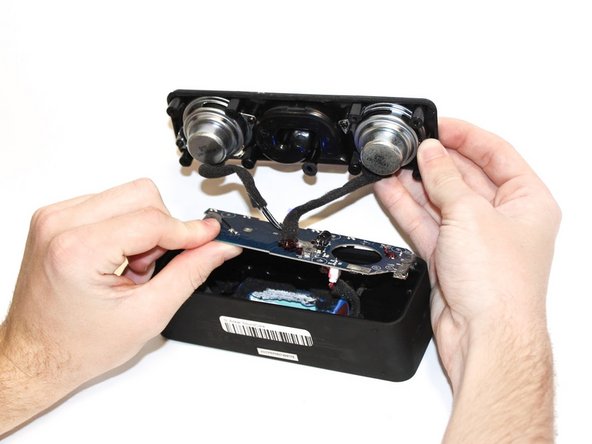

This procedure is necessary if the Bluetooth chip is broken and needs to be replaced. If the device’s Bluetooth connection chip is broken, it stops the device from pairing at all and prevents any Bluetooth interaction.
Before attempting to replace anything, it is recommended that you look at this device’s troubleshooting guide.
If you wish to restore the Bluetooth ability of your speaker, you must desolder the Bluetooth chip and replace it. Beware this is incredibly hard to do. The procedure requires tools to open the speaker and unscrew the fastening screws. Soldering experience is needed.
    1. ANKER SoundCore Bluetooth Chip Replacement, Bluetooth Chip: crwdns2935265:01crwdnd2935265:01crwdnd2935265:03crwdne2935265:0 ANKER SoundCore Bluetooth Chip Replacement, Bluetooth Chip: crwdns2935265:01crwdnd2935265:02crwdnd2935265:03crwdne2935265:0 ANKER SoundCore Bluetooth Chip Replacement, Bluetooth Chip: crwdns2935265:01crwdnd2935265:03crwdnd2935265:03crwdne2935265:0
      • Use the plastic opening tool to pry off the screen.
      • Remove the screen from the device.
    2. ANKER SoundCore Bluetooth Chip Replacement: crwdns2935265:02crwdnd2935265:01crwdnd2935265:01crwdne2935265:0
      • Remove the eight 10 mm Phillips #0 screws from the speaker mount.
    3. ANKER SoundCore Bluetooth Chip Replacement: crwdns2935265:03crwdnd2935265:01crwdnd2935265:01crwdne2935265:0
      • Lift the speaker mount out of the speaker body.
    4. ANKER SoundCore Bluetooth Chip Replacement: crwdns2935265:04crwdnd2935265:01crwdnd2935265:01crwdne2935265:0
      • Remove the two 8mm Phillips #0 screws from the circuit board.
    5. ANKER SoundCore Bluetooth Chip Replacement: crwdns2935265:05crwdnd2935265:01crwdnd2935265:02crwdne2935265:0 ANKER SoundCore Bluetooth Chip Replacement: crwdns2935265:05crwdnd2935265:02crwdnd2935265:02crwdne2935265:0
      • Remove the circuit board from its mount.
    6. ANKER SoundCore Bluetooth Chip Replacement: crwdns2935265:06crwdnd2935265:01crwdnd2935265:01crwdne2935265:0
      • Flip the circuit board to the back side.
    7. ANKER SoundCore Bluetooth Chip Replacement: crwdns2935265:07crwdnd2935265:01crwdnd2935265:01crwdne2935265:0
      • Desolder the Bluetooth chip (on the right side of the board) and replace it with the new Bluetooth chip.
      • For help soldering and desoldering, follow this guide.
