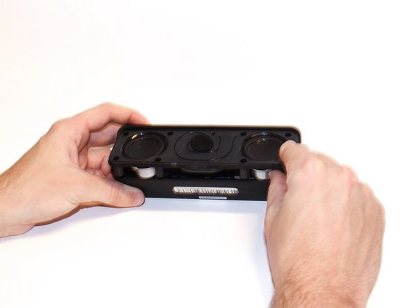

      • Use the plastic opening tool to pry off the screen.
      • Remove the screen from the device.
    2. ANKER SoundCore Battery/Battery Wire Replacement: crwdns2935265:02crwdnd2935265:01crwdnd2935265:01crwdne2935265:0
      • Remove the eight 10 mm Phillips #0 screws from the speaker mount.
      • Remove the speaker mount gently.

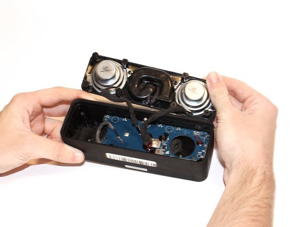

      • Remove the two 8mm Phillips #0 screws from the circuit board.
      • Remove the circuit board from its mount.

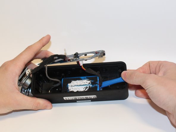

      • Find the battery below the circuit board.
      • It is covered by fuzz that is the same color as the black casing, so it may be hard to see.
      • Pry the battery off using the iFixit opening tool.
      • Remove the battery from its holder.

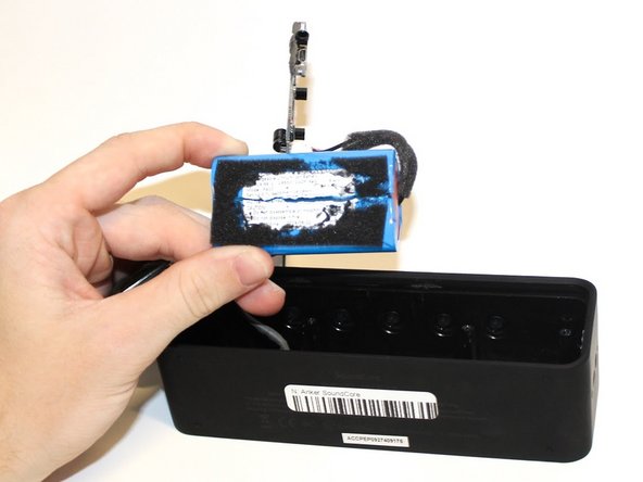

    5. ANKER SoundCore Battery/Battery Wire Replacement: crwdns2935265:05crwdnd2935265:01crwdnd2935265:01crwdne2935265:0
      • Desolder the battery wires.
      • Remove the battery and battery wire from the device.
      • For more information on soldering and desoldering connections, follow this guide.
