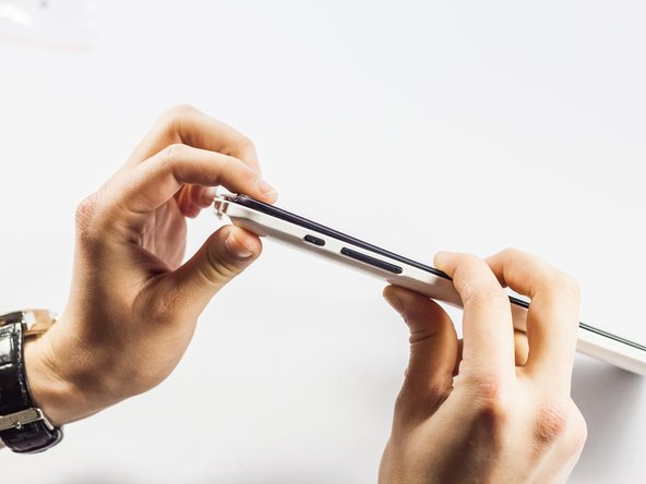

    • Remove screws.
    • Insert spudger tool on the middle of the left side, between the white and black plastic.
    • Slide in a plastic opening tool and use it to further pull the back off.
    • Work your way around the edge of the tablet with the plastic opening tool and insert more as needed.
    • Pull off the back cover.

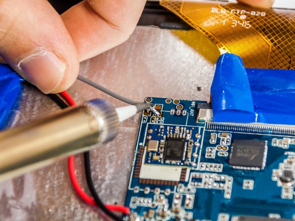

    • Plug in soldering iron and let it warm up for ten minutes.
    • Locate the the soldering points of the antenna on the motherboard.
    • Peel back the protective tape that covers the display ribbon cable so it isn't too close to the soldering points.
    • Solder hardens and cools quickly; you don’t need to wait to move on to the next step.

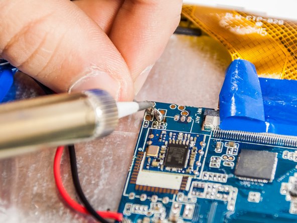

    • If you do not know how to solder, be careful and follow steps precisely because you could otherwise ruin the device.
    • With the new antenna locate the solder points.
    • Add solder to the solder points to allow soldering.
    • Place the antenna at each point and melt the solder point.
    • Place the antenna solder location into the melted solder blob and let it sit for about 2 seconds.
    • Repeat this step for each of the solder points.

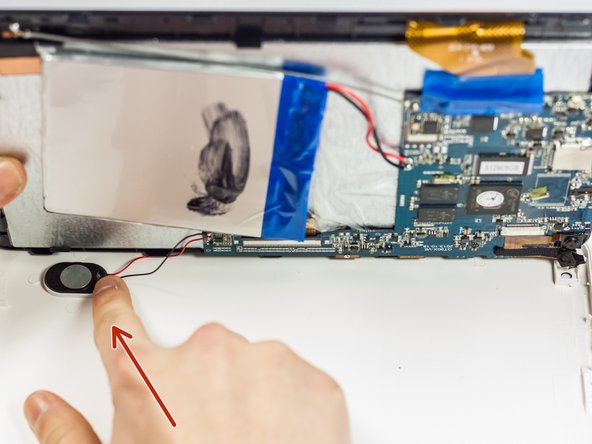

    • Replace the back cover with the new part in place.
    • Gently press the speaker into place.
    • Don't let the volume rocker unit fall out of place.
    • Replace the screws.
