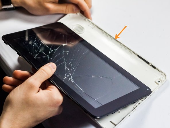

    • Remove screws
    • Insert spudger tool on the middle of the left side, between the white and black plastic
    • Slide in a plastic opening tool and use it to further pull the back off.
    • Work your way around the edge of the tablet with the plastic opening tool and insert more as needed
    • Pull off the back cover

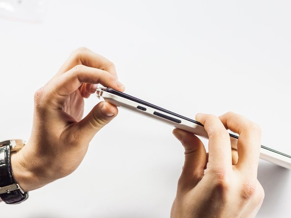

  2. AKASO KingPad A90 Volume Rocker/Power Button Unit Replacement: crwdns2935265:02crwdnd2935265:01crwdnd2935265:03crwdne2935265:0 AKASO KingPad A90 Volume Rocker/Power Button Unit Replacement: crwdns2935265:02crwdnd2935265:02crwdnd2935265:03crwdne2935265:0 AKASO KingPad A90 Volume Rocker/Power Button Unit Replacement: crwdns2935265:02crwdnd2935265:03crwdnd2935265:03crwdne2935265:0
    • Remove the broken volume rocker/power button unit.
    • Place the new part into the empty slot.
  3. AKASO KingPad A90 Volume Rocker/Power Button Unit Replacement: crwdns2935265:03crwdnd2935265:01crwdnd2935265:03crwdne2935265:0 AKASO KingPad A90 Volume Rocker/Power Button Unit Replacement: crwdns2935265:03crwdnd2935265:02crwdnd2935265:03crwdne2935265:0 AKASO KingPad A90 Volume Rocker/Power Button Unit Replacement: crwdns2935265:03crwdnd2935265:03crwdnd2935265:03crwdne2935265:0
    • Gently press the speaker into place.
    • Replace the back cover with the new part in place.
    • Be careful to not let the volume rocker unit fall out of place.
    • Replace the screws.
