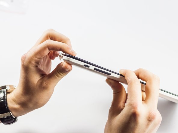

    • Remove screws.
    • Insert spudger tool on the middle of the left side, between the white and black plastic.
    • Slide in a plastic opening tool and use it to further pull the back off.
    • Work your way around the edge of the tablet with the plastic opening tool and insert more as needed.
    • Pull off the back cover.

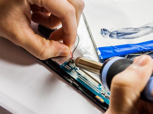

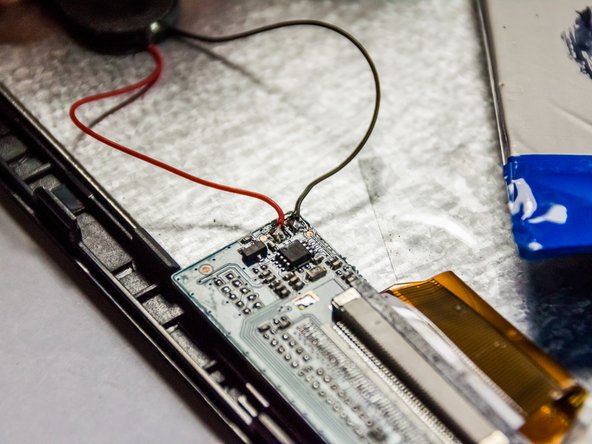

    • Plug in soldering iron and let it warm up for ten minutes.
    • Locate the speaker solder points and note where it is attached to the motherboard.
    • Solder the old speaker out of its mark. (Touch the tip of the solder iron to the soldering point).
  3. AKASO KingPad A90 Rear Speaker Replacement: crwdns2935265:03crwdnd2935265:01crwdnd2935265:03crwdne2935265:0 AKASO KingPad A90 Rear Speaker Replacement: crwdns2935265:03crwdnd2935265:02crwdnd2935265:03crwdne2935265:0 AKASO KingPad A90 Rear Speaker Replacement: crwdns2935265:03crwdnd2935265:03crwdnd2935265:03crwdne2935265:0
    • Solder the new speaker onto the points where the old speaker was.

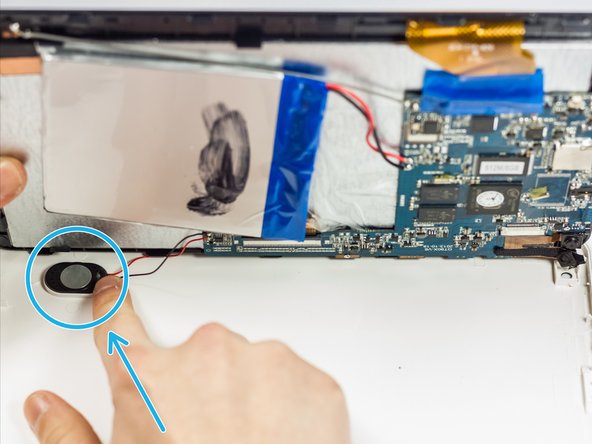

    • Replace the back cover with the new rear speaker unit in place.
    • Gently press the speaker into place.
    • Don't let the volume rocker unit fall out of place.
    • Replace the screws.
