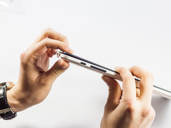

    • Remove screws.
    • Insert spudger tool on the middle of the left side, between the white and black plastic.
    • Slide in a plastic opening tool and use it to further pull the back off.
    • Work your way around the edge of the tablet with the plastic opening tool and insert more as needed.
    • Pull off the back cover.

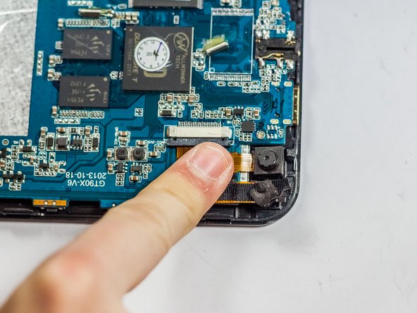

    • Locate the camera unit and note where it is attached to the motherboard.
    • Grasp the camera unit with tweezers or fingers, and pull firmly to remove it from the adhesive holding it to the motherboard.
    • Be careful when lifting up the camera unit. Don’t tear the ribbon cable! Ensure that you examine the second picture of this step.
    • Using the spudger, carefully loosen the slot's plastic cover piece holding the ribbon cable in place.
    • Pull the ribbon cable out.
    • Remove the old adhesive with tweezers.

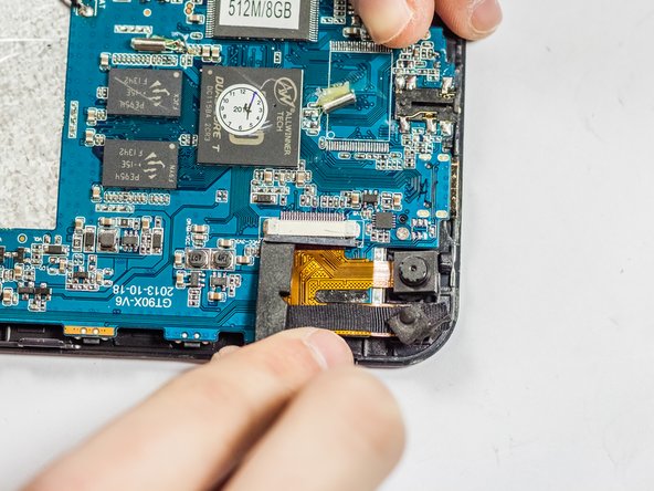

  3. AKASO KingPad A90 Camera (Rear and Front) Unit Replacement: crwdns2935265:03crwdnd2935265:01crwdnd2935265:03crwdne2935265:0 AKASO KingPad A90 Camera (Rear and Front) Unit Replacement: crwdns2935265:03crwdnd2935265:02crwdnd2935265:03crwdne2935265:0 AKASO KingPad A90 Camera (Rear and Front) Unit Replacement: crwdns2935265:03crwdnd2935265:03crwdnd2935265:03crwdne2935265:0
    • Apply a small square of new adhesive in the same spot as the old adhesive was previously.
    • Gently slide the new camera unit's ribbon cable into the slot.
    • Give the ribbon a firm push to make sure it has made contact.
    • Press the plastic cover piece back in place with the spudger.
    • Firmly press the new camera onto the adhesive, making sure to line it up correctly.

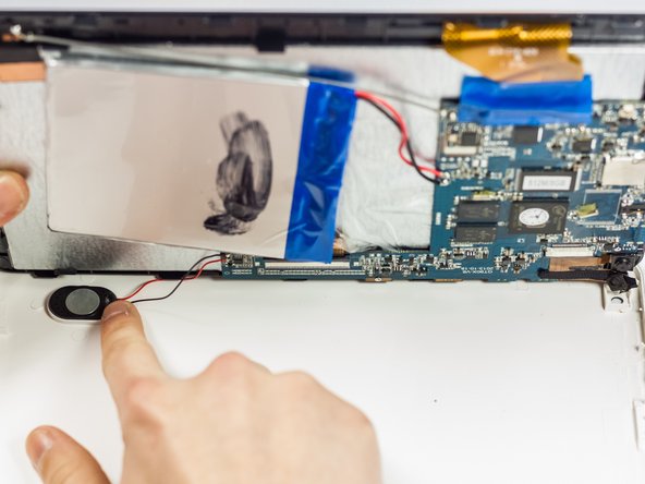

    • Replace the back cover with the new camera unit in place.
    • Gently press the speaker into place.
    • Don't let the volume rocker unit fall out of place.
    • Replace the screws.
