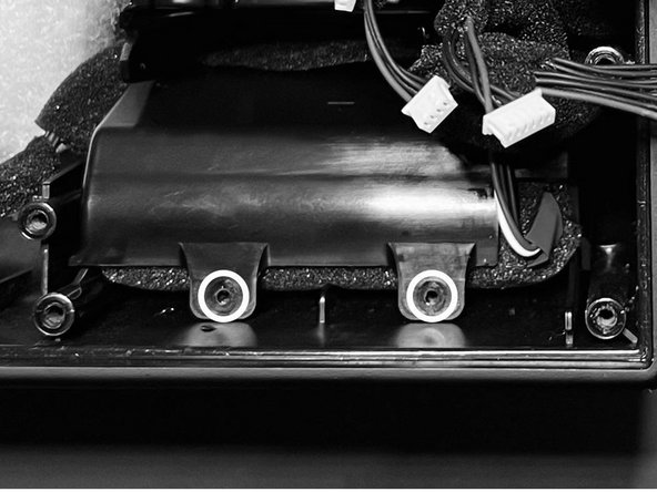

  2. AIAIAI Repair guide: UNIT-4 battery, Remove battery pack screws and battery packs: crwdns2935265:05crwdnd2935265:01crwdnd2935265:02crwdne2935265:0 AIAIAI Repair guide: UNIT-4 battery, Remove battery pack screws and battery packs: crwdns2935265:05crwdnd2935265:02crwdnd2935265:02crwdne2935265:0
    • Take a screwdriver and remove the 2 screws from each side.
    • Lift out the battery packs.
    • Slide battery packs in to place. The pack with the connectors is on the right hand side.
    • Push the connecting cable underneath the bass vent.
    • Hand tighten the 2 screws in each side.
