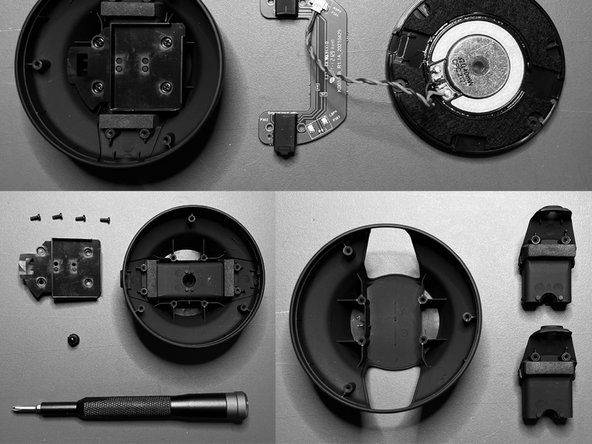

  1. AIAIAI Repair guide: TMA-2 speaker units MKII, TOOLS: crwdns2935265:01crwdnd2935265:01crwdnd2935265:01crwdne2935265:0
    • All you need is a small cross head screwdriver. We use a Phillips 00.
  2. AIAIAI Repair guide: TMA-2 speaker units MKII, DISASSEMBLY: crwdns2935265:02crwdnd2935265:01crwdnd2935265:02crwdne2935265:0 AIAIAI Repair guide: TMA-2 speaker units MKII, DISASSEMBLY: crwdns2935265:02crwdnd2935265:02crwdnd2935265:02crwdne2935265:0
    • Remove all 3 screws in the speaker plate
    • Carefully take out the speaker plate
    • Remove all 4 screws from the headband-connector plate and place it on the side
    • Remove all 4 screws from the pin plate and take out the pin plate and pin
    • Remove the tunnel - they are press fitted, so carefully press the outside of the tunnel to take it out
    • Remove the second tunnel
  3. AIAIAI Repair guide: TMA-2 speaker units MKII, SPEAKER UNIT DISASSEMBLED: crwdns2935265:03crwdnd2935265:01crwdnd2935265:01crwdne2935265:0
    • Speaker unit disassembled
  4. AIAIAI Repair guide: TMA-2 speaker units MKII, TROUBLESHOOTING: NO AUDIO: crwdns2935265:04crwdnd2935265:01crwdnd2935265:01crwdne2935265:0
    • When disassembled, check the two wires on the speaker plate. Are they soldered firmly in place on the speaker driver? If not they can easily be soldered back in place.
    • If the pin is not working properly make sure the pin and pin plate are installed properly. It often helps disassemble and assemble it again. Usually the problem occurs if the pin plate is loose. Sometimes the screw holes in the housings get torn which makes the screws fall out and loosens the plate. This requires a replacement of the housing.
