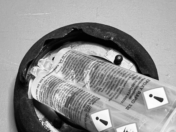

    • All you need is epoxy glue (or super glue if you do not have epoxy glue).

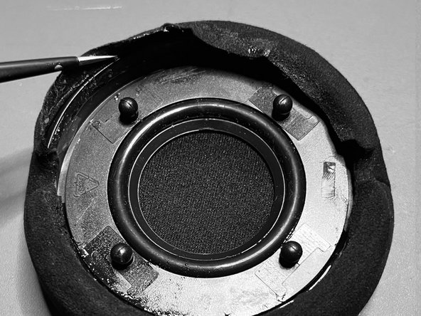

    • Hold the detached sides of the earpad up so you can get a clear view of where to apply the glue
    • Carefully apply the glue

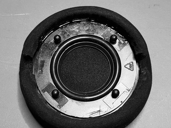

    • Press down the detached sides onto to the glue to make them stick
    • Press the sides for 2/3 minutes to make the glue apply
    • When the glue is in place and sticking, remove the excess glue
  3. AIAIAI Repair guide: TMA-2 over-ear earpads, EARPAD REPAIRED: crwdns2935265:03crwdnd2935265:01crwdnd2935265:01crwdne2935265:0
    • Earpad repaired
    • Optionally epoxy can be applied to further strengthen the glue.
    • If the earpad fits too tight on the speaker unit, it might be because of too much glue making it thicker. To fix this you will need to peel the sides off again and carefully remove the glue. After that make sure to apply a thinner layer of glue.
