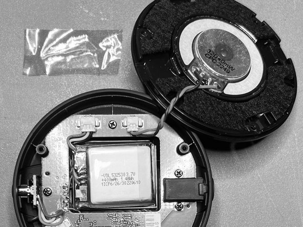

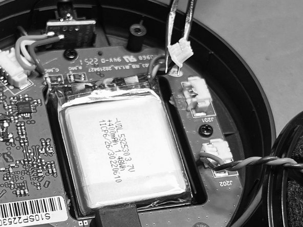

    • All you need is a small cross head screwdriver. We use a Phillips 00.
  2. AIAIAI Repair guide: S10 battery, DISASSEMBLY: crwdns2935265:02crwdnd2935265:01crwdnd2935265:03crwdne2935265:0 AIAIAI Repair guide: S10 battery, DISASSEMBLY: crwdns2935265:02crwdnd2935265:02crwdnd2935265:03crwdne2935265:0 AIAIAI Repair guide: S10 battery, DISASSEMBLY: crwdns2935265:02crwdnd2935265:03crwdnd2935265:03crwdne2935265:0
    • Remove all 3 screws in the speaker plate.
    • Carefully lift out the speaker plate.
    • Disconnect the battery.
    • Carefully pull the battery off of the pin plate.
    • Replace with new battery.
