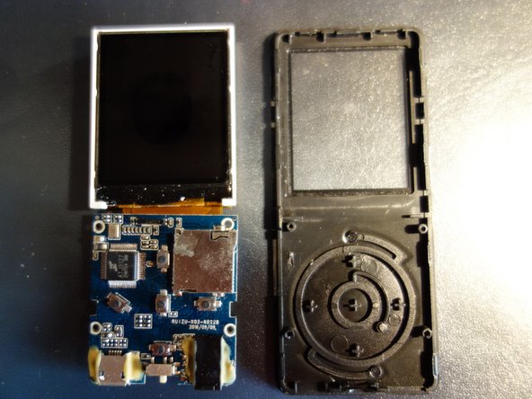

    • Remove the microSD card, if present. You can use a flat side of a spudger
  2. AGPTEK A02 Teardown: crwdns2935265:02crwdnd2935265:01crwdnd2935265:02crwdne2935265:0 AGPTEK A02 Teardown: crwdns2935265:02crwdnd2935265:02crwdnd2935265:02crwdne2935265:0
    • With a Pick, insert the tool and split the two parts that make the shell of the mp3 player
    • Use Jimmy, if the pick is too flexible for you

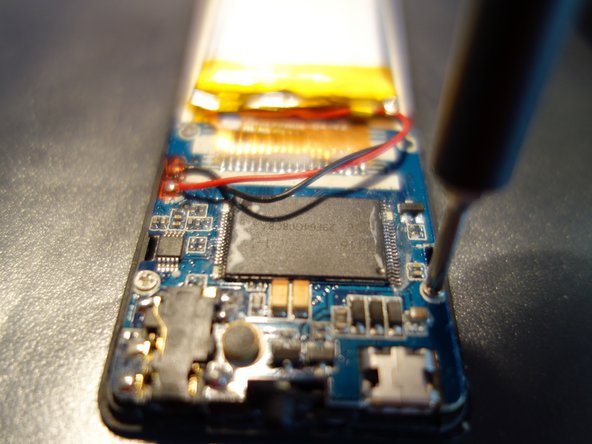

  3. AGPTEK A02 Teardown: crwdns2935265:03crwdnd2935265:01crwdnd2935265:03crwdne2935265:0 AGPTEK A02 Teardown: crwdns2935265:03crwdnd2935265:02crwdnd2935265:03crwdne2935265:0 AGPTEK A02 Teardown: crwdns2935265:03crwdnd2935265:03crwdnd2935265:03crwdne2935265:0
    • Remove 3 screws with a #00 Philips screwdriver

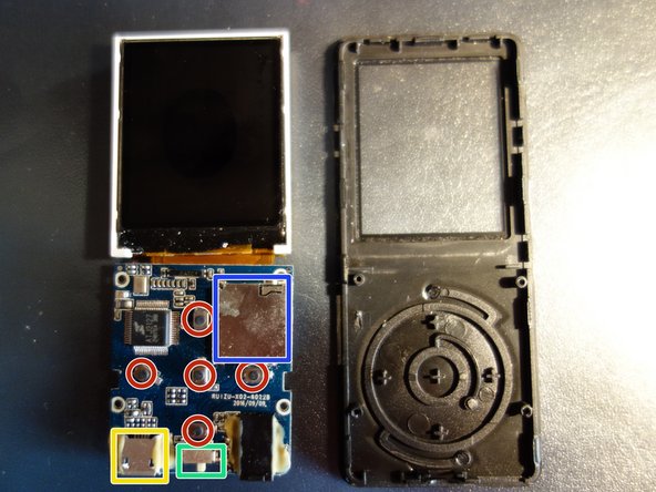

  4. AGPTEK A02 Teardown: crwdns2935265:04crwdnd2935265:01crwdnd2935265:01crwdne2935265:0
    • Remove the switch with the shape of a spudger
  5. AGPTEK A02 Teardown: crwdns2935265:05crwdnd2935265:01crwdnd2935265:03crwdne2935265:0 AGPTEK A02 Teardown: crwdns2935265:05crwdnd2935265:02crwdnd2935265:03crwdne2935265:0 AGPTEK A02 Teardown: crwdns2935265:05crwdnd2935265:03crwdnd2935265:03crwdne2935265:0
    • That's all. The screen is welded and coated with glue.
    • command bottons
    • usb port
    • the switch
    • SD card holder

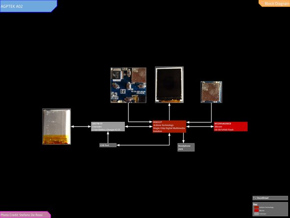

  6. AGPTEK A02 Teardown: crwdns2935265:06crwdnd2935265:01crwdnd2935265:02crwdne2935265:0 AGPTEK A02 Teardown: crwdns2935265:06crwdnd2935265:02crwdnd2935265:02crwdne2935265:0
    • Full IC Identification:
    • Predicted Block Diagram is on the 2nd image.
    • You may need to enlarge it to view the text.
