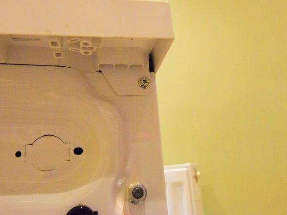

  3. AEG Lavamat L14850 washer dryer Inlet valve Replacement, Remove top lid: crwdns2935265:03crwdnd2935265:01crwdnd2935265:02crwdne2935265:0 AEG Lavamat L14850 washer dryer Inlet valve Replacement, Remove top lid: crwdns2935265:03crwdnd2935265:02crwdnd2935265:02crwdne2935265:0
    • The top lid is held in place with two screws at the back as indicated. Remove these, and lift the lid off

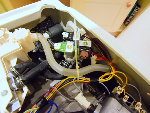

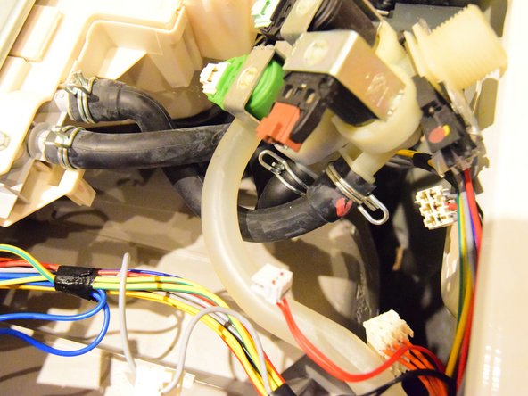

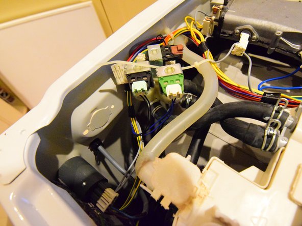

  4. AEG Lavamat L14850 washer dryer Inlet valve Replacement, Locate the valve: crwdns2935265:04crwdnd2935265:01crwdnd2935265:03crwdne2935265:0 AEG Lavamat L14850 washer dryer Inlet valve Replacement, Locate the valve: crwdns2935265:04crwdnd2935265:02crwdnd2935265:03crwdne2935265:0 AEG Lavamat L14850 washer dryer Inlet valve Replacement, Locate the valve: crwdns2935265:04crwdnd2935265:03crwdnd2935265:03crwdne2935265:0
    • The valve is located at the rear of the washing machine, near the water inlet point to the washing machine. In fact, it is part of it.
    • The valve has several hoses connected to it, and electrical connectors as well. Take pictures from all angles to capture which connectors and which hoses go where.

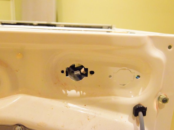

  5. AEG Lavamat L14850 washer dryer Inlet valve Replacement, Disconnect the valve: crwdns2935265:05crwdnd2935265:01crwdnd2935265:03crwdne2935265:0 AEG Lavamat L14850 washer dryer Inlet valve Replacement, Disconnect the valve: crwdns2935265:05crwdnd2935265:02crwdnd2935265:03crwdne2935265:0 AEG Lavamat L14850 washer dryer Inlet valve Replacement, Disconnect the valve: crwdns2935265:05crwdnd2935265:03crwdnd2935265:03crwdne2935265:0
    • Disconnect all wires
    • Remove all the hoses connected to the valve
    • Remove the two screws that hold it on the rear panel
    • Lift the valve out

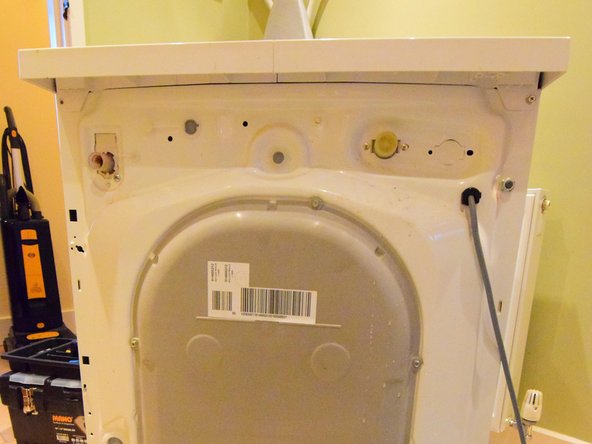

  6. AEG Lavamat L14850 washer dryer Inlet valve Replacement, The valve is out: crwdns2935265:06crwdnd2935265:01crwdnd2935265:02crwdne2935265:0 AEG Lavamat L14850 washer dryer Inlet valve Replacement, The valve is out: crwdns2935265:06crwdnd2935265:02crwdnd2935265:02crwdne2935265:0
    • Two pictures showing the washing machine without the valve, and the valve placed alongside the replacement unit
