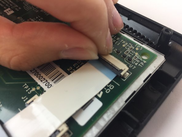

    • Disconnect the three ribbon cables from their insulation-displacement connectors by flipping up the black plastic clip.
    • Gently pull the ribbon cables out of their insulation-displacement connectors.

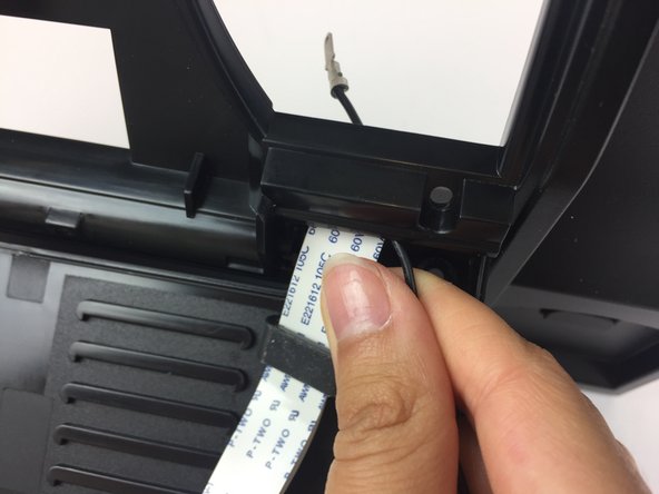

    • Disconnect the blade connector from the blade receptacle by gripping the exposed area of the blade connector.
    • Gently pull the blade connector out of the blade receptacle.

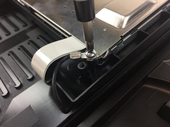

    • Place the video screen face down to expose the two screws. The screws are indicated by the red circles.
  15. ACN Iris WG4K Video Screen Ribbon Cable Replacement: crwdns2935265:015crwdnd2935265:01crwdnd2935265:02crwdne2935265:0 ACN Iris WG4K Video Screen Ribbon Cable Replacement: crwdns2935265:015crwdnd2935265:02crwdnd2935265:02crwdne2935265:0
    • Use the Phillips #0 Screwdriver to remove the two Phillips head screws (6 mm)

    • Pull the ribbon connector and blade connector through the top case.

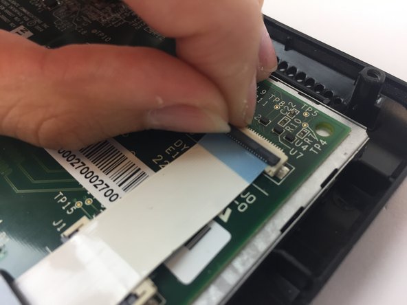

    • The two ribbon connectors are indicated by the red rectangles.
    • Disconnect the two ribbon cables from their insulation-displacement connectors by flipping up the black plastic clip.
    • Gently pull out the ribbon cables. Gently pull out the ribbon cables.
