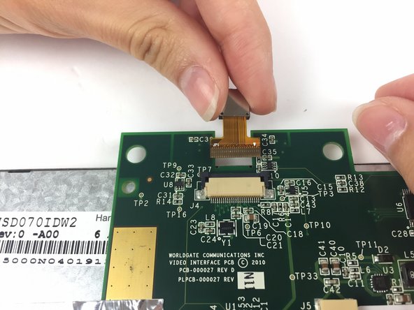

  19. ACN Iris WG4K Video Camera Replacement, Video Screen: crwdns2935265:019crwdnd2935265:01crwdnd2935265:01crwdne2935265:0
    • Gently lift the video screen out of its case.

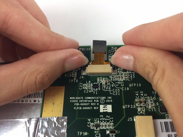

  20. ACN Iris WG4K Video Camera Replacement, Video Camera: crwdns2935265:020crwdnd2935265:01crwdnd2935265:03crwdne2935265:0 ACN Iris WG4K Video Camera Replacement, Video Camera: crwdns2935265:020crwdnd2935265:02crwdnd2935265:03crwdne2935265:0 ACN Iris WG4K Video Camera Replacement, Video Camera: crwdns2935265:020crwdnd2935265:03crwdnd2935265:03crwdne2935265:0
    • Flip the video screen over so that the screen itself is face-down on a flat surface to expose the camera.
    • Push up on the two clips located on the right and left side of the video camera simultaneously.
    • Gently pull the camera out.
