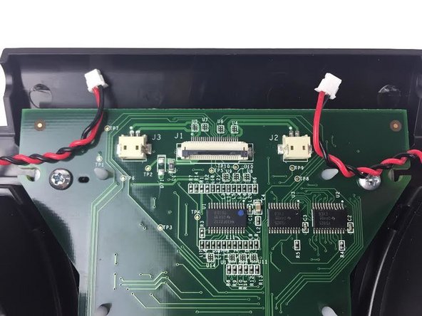

    • Gently lift up on the upper case to separate it from the keypad/speaker panel.
    • The ribbon cable is highlighted by the red rectangle.
    • The 2-pin JST connectors are highlighted by the orange squares.

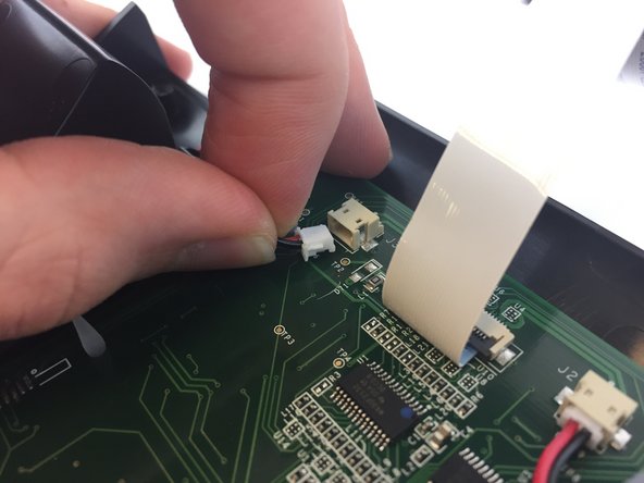

    • Disconnect the two white 2-pin JST connectors from the keypad/speaker circuit board by tugging gently until they release.

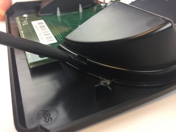

    • The red markers indicate the four plastic clips arranged around the base of each speaker housing.
    • Use a plastic spudger to push in the four plastic clips.

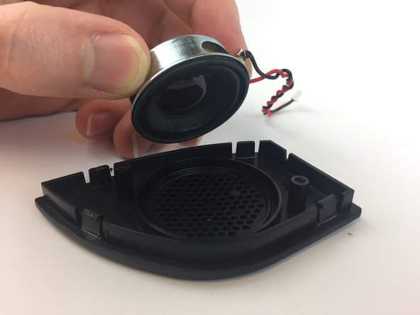

  12. ACN Iris WG4K Speakers Replacement: crwdns2935265:012crwdnd2935265:01crwdnd2935265:02crwdne2935265:0 ACN Iris WG4K Speakers Replacement: crwdns2935265:012crwdnd2935265:02crwdnd2935265:02crwdne2935265:0

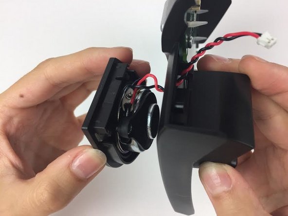

    • Once both speakers have been unclipped, gently pull the wire through the housing .
  13. ACN Iris WG4K Speakers Replacement: crwdns2935265:013crwdnd2935265:01crwdnd2935265:03crwdne2935265:0 ACN Iris WG4K Speakers Replacement: crwdns2935265:013crwdnd2935265:02crwdnd2935265:03crwdne2935265:0 ACN Iris WG4K Speakers Replacement: crwdns2935265:013crwdnd2935265:03crwdnd2935265:03crwdne2935265:0

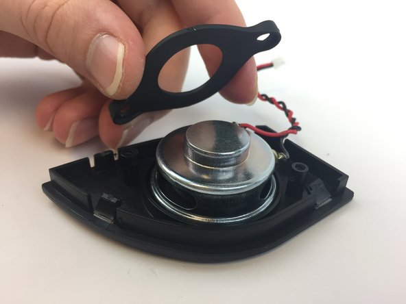

    • Use the Phillips #0 Screwdriver to remove the two Phillips head screws (6 mm)
    • Gently lift up the black cover to expose the now freed speaker.
