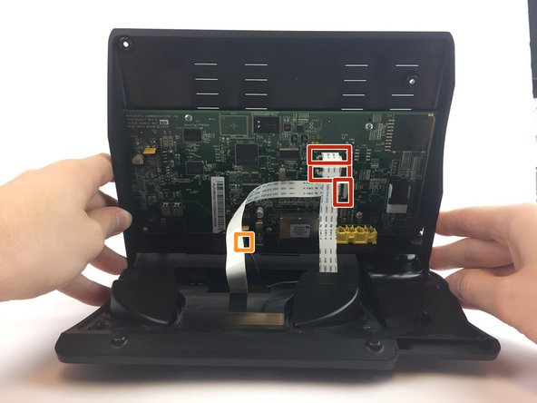

  3. ACN Iris WG4K Motherboard Replacement: crwdns2935265:03crwdnd2935265:01crwdnd2935265:02crwdne2935265:0 ACN Iris WG4K Motherboard Replacement: crwdns2935265:03crwdnd2935265:02crwdnd2935265:02crwdne2935265:0
    • Lift the back case upwards to expose the inside components.
    • Red rectangles indicate the three ribbon cables.
    • The orange square indicates the blade connector.

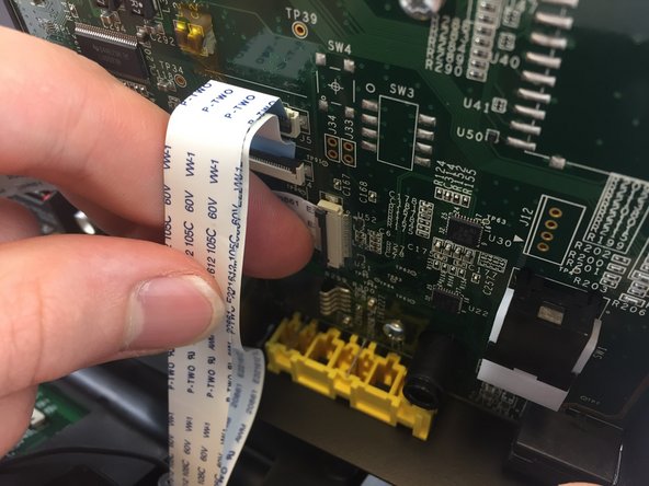

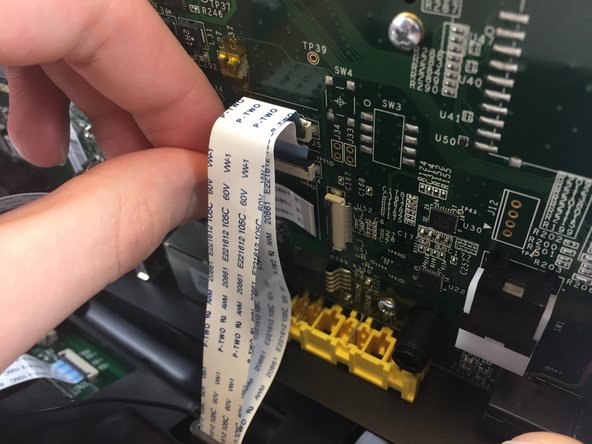

  4. ACN Iris WG4K Motherboard Replacement: crwdns2935265:04crwdnd2935265:01crwdnd2935265:03crwdne2935265:0 ACN Iris WG4K Motherboard Replacement: crwdns2935265:04crwdnd2935265:02crwdnd2935265:03crwdne2935265:0 ACN Iris WG4K Motherboard Replacement: crwdns2935265:04crwdnd2935265:03crwdnd2935265:03crwdne2935265:0
    • Disconnect the three ribbon cables from their insulation-displacement connectors by flipping up the black plastic clip.
    • Gently pull the ribbon cables out of their insulation-displacement connectors.

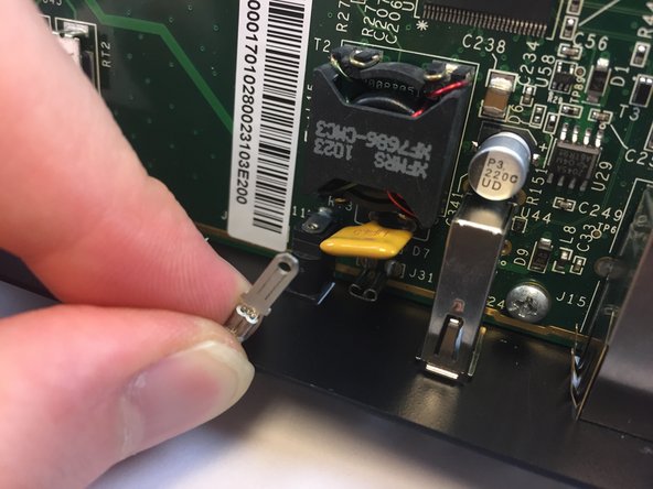

  5. ACN Iris WG4K Motherboard Replacement: crwdns2935265:05crwdnd2935265:01crwdnd2935265:02crwdne2935265:0 ACN Iris WG4K Motherboard Replacement: crwdns2935265:05crwdnd2935265:02crwdnd2935265:02crwdne2935265:0
    • Disconnect the blade connector from the blade receptacle by gripping the exposed area of the blade connector.
    • Gently pull the blade connector out of the blade receptacle.

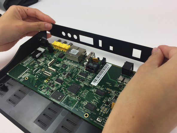

  8. ACN Iris WG4K Motherboard Replacement: crwdns2935265:08crwdnd2935265:01crwdnd2935265:02crwdne2935265:0 ACN Iris WG4K Motherboard Replacement: crwdns2935265:08crwdnd2935265:02crwdnd2935265:02crwdne2935265:0
    • Firmly grasp the black port wall.
    • Pull up and push out to remove it from the lower case.
  9. ACN Iris WG4K Motherboard Replacement: crwdns2935265:09crwdnd2935265:01crwdnd2935265:01crwdne2935265:0
    • Gently lift the motherboard out of the lower case.
