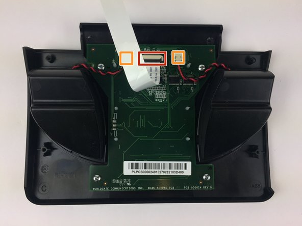

  8. ACN Iris WG4K Keypad Ribbon Cable Replacement: crwdns2935265:08crwdnd2935265:01crwdnd2935265:02crwdne2935265:0 ACN Iris WG4K Keypad Ribbon Cable Replacement: crwdns2935265:08crwdnd2935265:02crwdnd2935265:02crwdne2935265:0
    • Gently lift up on the upper case to separate it from the keypad/speaker panel.
    • The ribbon cable is highlighted by the red rectangle.
    • The 2-pin JST connectors are highlighted by the orange squares.

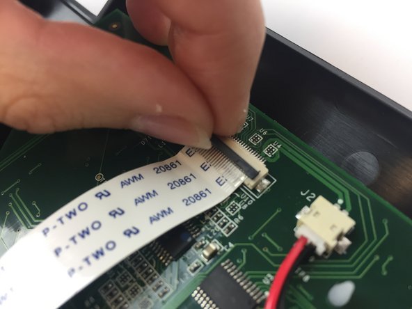

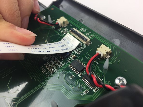

  9. ACN Iris WG4K Keypad Ribbon Cable Replacement: crwdns2935265:09crwdnd2935265:01crwdnd2935265:03crwdne2935265:0 ACN Iris WG4K Keypad Ribbon Cable Replacement: crwdns2935265:09crwdnd2935265:02crwdnd2935265:03crwdne2935265:0 ACN Iris WG4K Keypad Ribbon Cable Replacement: crwdns2935265:09crwdnd2935265:03crwdnd2935265:03crwdne2935265:0
    • Disconnect the ribbon cable from its insulation-displacement connector by flipping up the black plastic clip.
    • Gently pull the ribbon cable out of its insulation-displacement connector.
