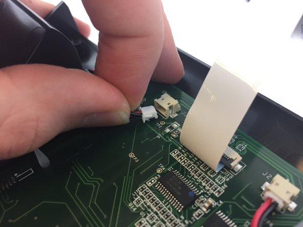

  9. ACN Iris WG4K Key Pad Replacement: crwdns2935265:09crwdnd2935265:01crwdnd2935265:02crwdne2935265:0 ACN Iris WG4K Key Pad Replacement: crwdns2935265:09crwdnd2935265:02crwdnd2935265:02crwdne2935265:0
    • Disconnect the two white 2-pin JST connectors from the keypad/speaker circuit board by tugging gently until they are released.
