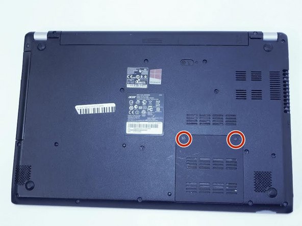

    • Make sure you completely power off the device before proceeding.
    • Turn over the device to display the back cover and remove the two marked Phillips #0 screws.

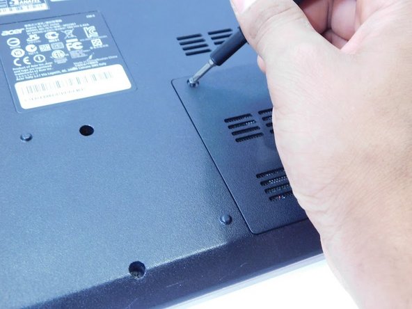

  2. ACER Aspire V5-571P-6609 RAM Replacement: crwdns2935265:02crwdnd2935265:01crwdnd2935265:03crwdne2935265:0 ACER Aspire V5-571P-6609 RAM Replacement: crwdns2935265:02crwdnd2935265:02crwdnd2935265:03crwdne2935265:0 ACER Aspire V5-571P-6609 RAM Replacement: crwdns2935265:02crwdnd2935265:03crwdnd2935265:03crwdne2935265:0
    • Once the screws have been removed, utilize a jimmy tool to pry open the back cover. Carefully lift the cover and set it aside for now.

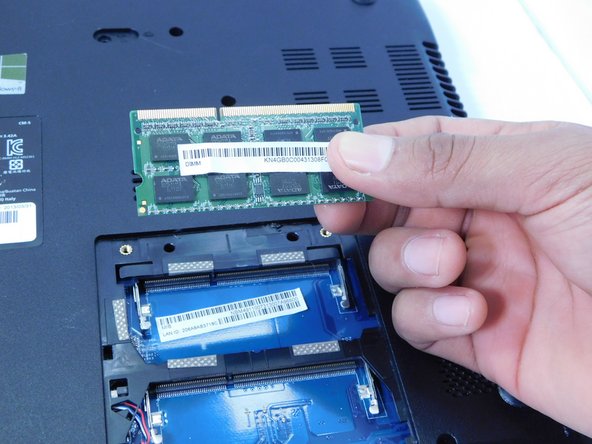

    • With two fingers, push the latches holding the DIMM to the sides.
    • The DIMM will tilt upward once it is released from the slot.
    • Carefully secure the DIMM and remove it.
  4. ACER Aspire V5-571P-6609 RAM Replacement: crwdns2935265:04crwdnd2935265:01crwdnd2935265:03crwdne2935265:0 ACER Aspire V5-571P-6609 RAM Replacement: crwdns2935265:04crwdnd2935265:02crwdnd2935265:03crwdne2935265:0 ACER Aspire V5-571P-6609 RAM Replacement: crwdns2935265:04crwdnd2935265:03crwdnd2935265:03crwdne2935265:0
    • Repeat the same process from the previous step for the second slot.
  5. ACER Aspire V5-571P-6609 RAM Replacement: crwdns2935265:05crwdnd2935265:01crwdnd2935265:02crwdne2935265:0 ACER Aspire V5-571P-6609 RAM Replacement: crwdns2935265:05crwdnd2935265:02crwdnd2935265:02crwdne2935265:0
    • Insert the replacement DIMM into the slot.
    • Once inserted, push the DIMM down gently until it snaps into place.
