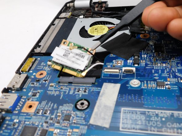

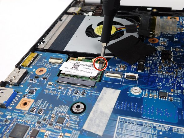

    • Use tweezers to gently detach black and white Wi-Fi card cables shown here by lifting up until they pop off.
    • Once both cables are detached, unscrew the single screw holding Wireless LAN card in place.
    • The Wi-Fi card should lift up slightly on its own. Use tweezers to gently lift the Wi-Fi card out at a 45 degree angle to prevent damage.

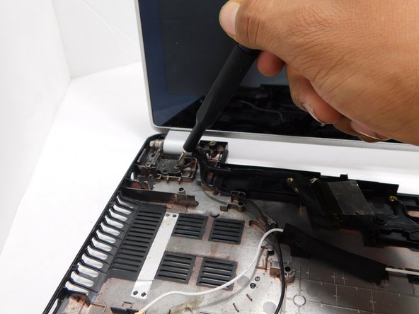

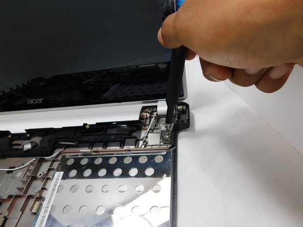

    • Use tweezers to gently lift the tape holding down the white cable until tape is unstuck. Unthread black and white cables until free of the bottom panel.
    • Unscrew the Phillips #0 left side screws until left side of display is now lose.
    • Do the same for the two flat screws on the right side.
  13. ACER Aspire V5-571P-6609 Display Replacement: crwdns2935265:013crwdnd2935265:01crwdnd2935265:01crwdne2935265:0
    • Display should now lift free of the main body of the Laptop.
    • Safely dispose of broken display and replace with new display.
