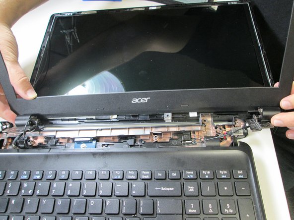

  11. ACER Aspire E1-572-6870 Screen Replacement: crwdns2935265:011crwdnd2935265:01crwdnd2935265:02crwdne2935265:0 ACER Aspire E1-572-6870 Screen Replacement: crwdns2935265:011crwdnd2935265:02crwdnd2935265:02crwdne2935265:0
    • Lift the top panel all the way up and your laptop is now split into its two distinct halves.

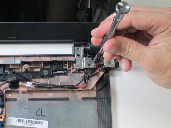

  13. ACER Aspire E1-572-6870 Screen Replacement: crwdns2935265:013crwdnd2935265:01crwdnd2935265:01crwdne2935265:0
    • Unscrew the #00 Phillips screws holding the hinge together on each side of the screen.

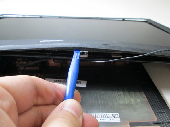

  14. ACER Aspire E1-572-6870 Screen Replacement: crwdns2935265:014crwdnd2935265:01crwdnd2935265:03crwdne2935265:0 ACER Aspire E1-572-6870 Screen Replacement: crwdns2935265:014crwdnd2935265:02crwdnd2935265:03crwdne2935265:0 ACER Aspire E1-572-6870 Screen Replacement: crwdns2935265:014crwdnd2935265:03crwdnd2935265:03crwdne2935265:0
    • Use a plastic opening tool to carefully separate the plastic frame from the screen.

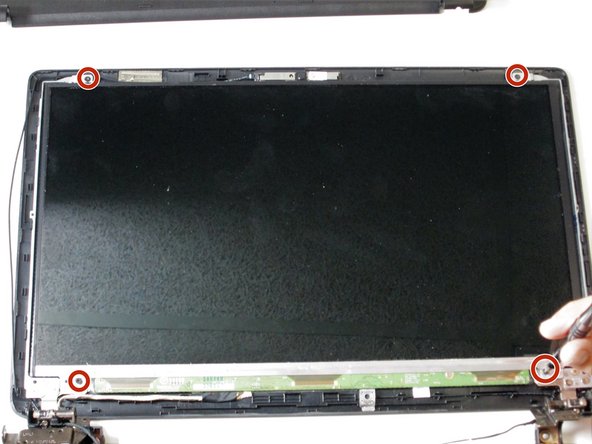

  15. ACER Aspire E1-572-6870 Screen Replacement: crwdns2935265:015crwdnd2935265:01crwdnd2935265:02crwdne2935265:0 ACER Aspire E1-572-6870 Screen Replacement: crwdns2935265:015crwdnd2935265:02crwdnd2935265:02crwdne2935265:0
    • Remove the four 1.4 x 2 mm Phillips #00 screws with a Phillips #00 screwdriver.

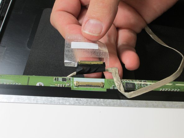

  17. ACER Aspire E1-572-6870 Screen Replacement: crwdns2935265:017crwdnd2935265:01crwdnd2935265:02crwdne2935265:0 ACER Aspire E1-572-6870 Screen Replacement: crwdns2935265:017crwdnd2935265:02crwdnd2935265:02crwdne2935265:0
    • Peel back the tape holding the electrical connecting cord to the screen.
    • Remove connector from port.
