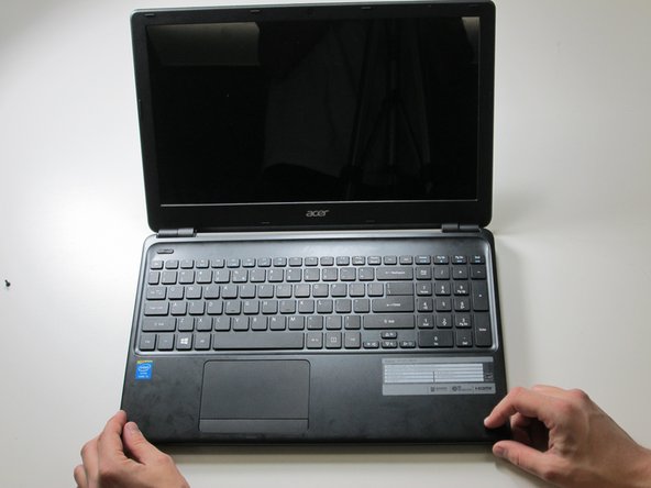

    • Carefully flip your laptop back over and open it up.
  8. ACER Aspire E1-572-6870 Fan Replacement: crwdns2935265:08crwdnd2935265:01crwdnd2935265:03crwdne2935265:0 ACER Aspire E1-572-6870 Fan Replacement: crwdns2935265:08crwdnd2935265:02crwdnd2935265:03crwdne2935265:0 ACER Aspire E1-572-6870 Fan Replacement: crwdns2935265:08crwdnd2935265:03crwdnd2935265:03crwdne2935265:0

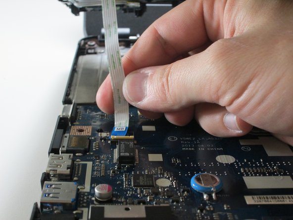

    • Locate the three ribbons that need to be unplugged, so the two halves of the device may be separated.
    • Unplug the large ribbon by sliding the retainer clip backward (toward the hinges), then gently pulling the cable out of the connector.
  10. ACER Aspire E1-572-6870 Fan Replacement: crwdns2935265:010crwdnd2935265:01crwdnd2935265:03crwdne2935265:0 ACER Aspire E1-572-6870 Fan Replacement: crwdns2935265:010crwdnd2935265:02crwdnd2935265:03crwdne2935265:0 ACER Aspire E1-572-6870 Fan Replacement: crwdns2935265:010crwdnd2935265:03crwdnd2935265:03crwdne2935265:0
    • Remove the other two smaller ribbons by flipping open the small plastic tab that holds the ribbon in the connector.
    • Then simply pull the free ribbon out.

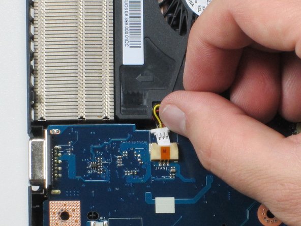

  12. ACER Aspire E1-572-6870 Fan Replacement, Fan: crwdns2935265:012crwdnd2935265:01crwdnd2935265:02crwdne2935265:0 ACER Aspire E1-572-6870 Fan Replacement, Fan: crwdns2935265:012crwdnd2935265:02crwdnd2935265:02crwdne2935265:0
    • Remove the electrical wiring from its connecting port.
