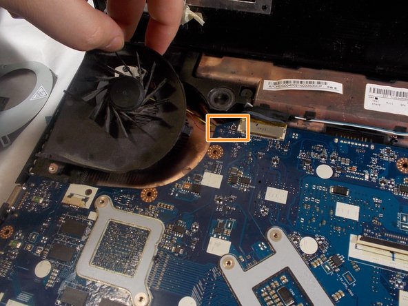

  4. ACER Aspire 7750G-6645 Fan Replacement: crwdns2935265:04crwdnd2935265:01crwdnd2935265:02crwdne2935265:0 ACER Aspire 7750G-6645 Fan Replacement: crwdns2935265:04crwdnd2935265:02crwdnd2935265:02crwdne2935265:0
    Desoldering Pump
    $3.99
    • Lift the fan up and away from the device. Do not remove the fan from the device.
    • Desolder the attached part using a Soldering Iron to heat it up and remove the leftover heated lead by using a Desoldering Pump.
    • If you aren't familiar with soldering, read our How to Solder and Desolder Connections guide for more information.
