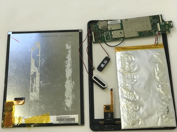

  11. AARP RealPad MA7BX2 Screen Replacement: crwdns2935265:011crwdnd2935265:01crwdnd2935265:01crwdne2935265:0
    • Take off the motherboard and set it aside. Your Finished product should look like this.

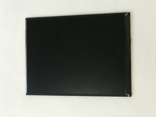

  12. AARP RealPad MA7BX2 Screen Replacement, Screen: crwdns2935265:012crwdnd2935265:01crwdnd2935265:03crwdne2935265:0 AARP RealPad MA7BX2 Screen Replacement, Screen: crwdns2935265:012crwdnd2935265:02crwdnd2935265:03crwdne2935265:0 AARP RealPad MA7BX2 Screen Replacement, Screen: crwdns2935265:012crwdnd2935265:03crwdnd2935265:03crwdne2935265:0
    • Use the suction cup to loosen and pull up the screen.
    • Be careful when pulling up screen. Too much force can lead to you breaking it.
