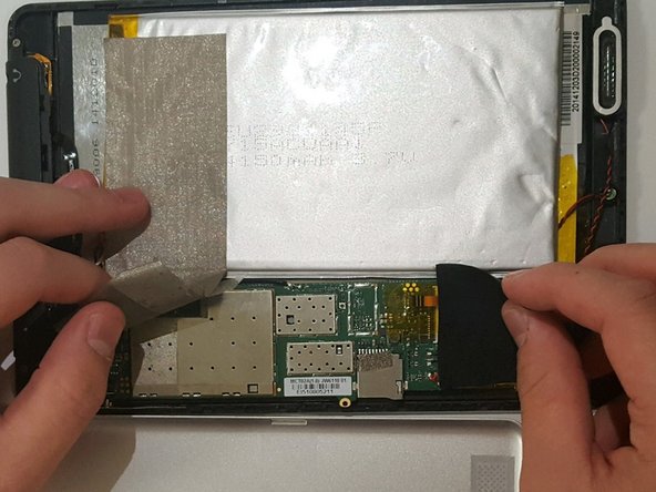

  3. AARP RealPad MA7BX2 Motherboard Replacement: crwdns2935265:03crwdnd2935265:01crwdnd2935265:02crwdne2935265:0 AARP RealPad MA7BX2 Motherboard Replacement: crwdns2935265:03crwdnd2935265:02crwdnd2935265:02crwdne2935265:0
    • The black tape is stuck to delicate wires; remove with caution.
    • Peel off the silver tape.
    • Gently pull off the black tape.

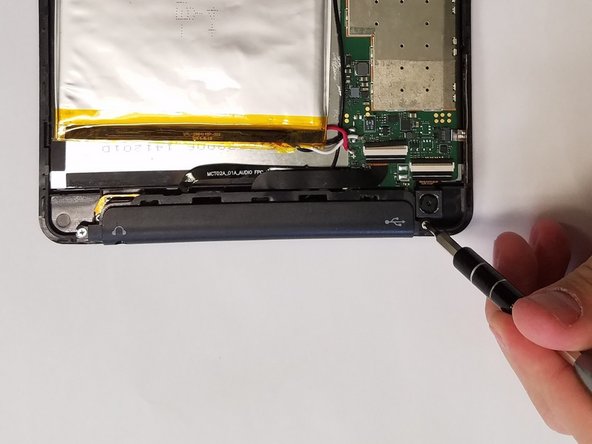

  4. AARP RealPad MA7BX2 Motherboard Replacement: crwdns2935265:04crwdnd2935265:01crwdnd2935265:02crwdne2935265:0 AARP RealPad MA7BX2 Motherboard Replacement: crwdns2935265:04crwdnd2935265:02crwdnd2935265:02crwdne2935265:0
    • Using a JIS #000 screwdriver, remove the two 2.5 mm screws.
  5. AARP RealPad MA7BX2 Motherboard Replacement: crwdns2935265:05crwdnd2935265:01crwdnd2935265:02crwdne2935265:0 AARP RealPad MA7BX2 Motherboard Replacement: crwdns2935265:05crwdnd2935265:02crwdnd2935265:02crwdne2935265:0
    • Lift off the black audio cover.

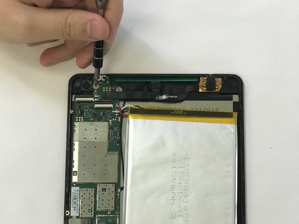

  6. AARP RealPad MA7BX2 Motherboard Replacement, Motherboard: crwdns2935265:06crwdnd2935265:01crwdnd2935265:02crwdne2935265:0 AARP RealPad MA7BX2 Motherboard Replacement, Motherboard: crwdns2935265:06crwdnd2935265:02crwdnd2935265:02crwdne2935265:0

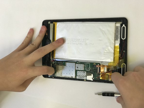

    • Remove the two JIS #000 screws.
  7. AARP RealPad MA7BX2 Motherboard Replacement: crwdns2935265:07crwdnd2935265:01crwdnd2935265:02crwdne2935265:0 AARP RealPad MA7BX2 Motherboard Replacement: crwdns2935265:07crwdnd2935265:02crwdnd2935265:02crwdne2935265:0
    • Flip up the small black connectors using a spudger or your nails.
    • Be careful when flipping them up. Too much force can cause them to break.

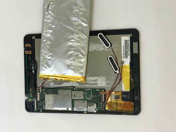

  9. AARP RealPad MA7BX2 Motherboard Replacement: crwdns2935265:09crwdnd2935265:01crwdnd2935265:02crwdne2935265:0 AARP RealPad MA7BX2 Motherboard Replacement: crwdns2935265:09crwdnd2935265:02crwdnd2935265:02crwdne2935265:0
    • Use the tweezers to loosen up the sides of speakers by going into the gaps, before picking it up.
    • There are magnets holding down the speakers. Be careful as to not pick them up with the speakers.
    • The top of the speakers are very fragile and may fall out at the slightest touch. Be careful when picking them up.

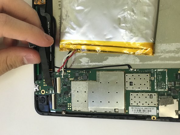

  10. AARP RealPad MA7BX2 Motherboard Replacement: crwdns2935265:010crwdnd2935265:01crwdnd2935265:02crwdne2935265:0 AARP RealPad MA7BX2 Motherboard Replacement: crwdns2935265:010crwdnd2935265:02crwdnd2935265:02crwdne2935265:0
    • Remove all wire connections by sliding them out of the connectors.
    • Be careful as to not forcefully pull out anything because the wires are very delicate.

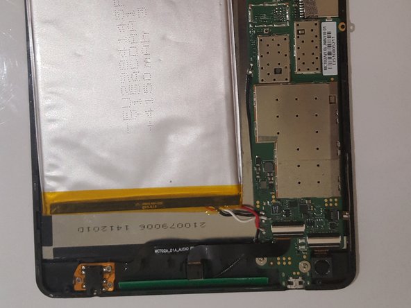

  11. AARP RealPad MA7BX2 Motherboard Replacement: crwdns2935265:011crwdnd2935265:01crwdnd2935265:01crwdne2935265:0
    • Take off the motherboard and set it aside. Your Finished product should look like this.
