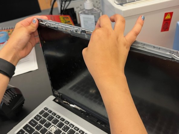

      • Remove the bezel
    2. A515-45 Screen Replacement: crwdns2935265:02crwdnd2935265:01crwdnd2935265:01crwdne2935265:0
      • If you followed this guide or there are accesible adhesive strips skip this step
      • heat from back and front of screen
    3. A515-45 Screen Replacement: crwdns2935265:03crwdnd2935265:01crwdnd2935265:02crwdne2935265:0 A515-45 Screen Replacement: crwdns2935265:03crwdnd2935265:02crwdnd2935265:02crwdne2935265:0
      iFixit Opening Picks (Set of 6)
      $4.95
      • Using a guitar pick remove screen
      • while doing that use tweezers to remove adhesive strips
    4. A515-45 Screen Replacement: crwdns2935265:04crwdnd2935265:01crwdnd2935265:01crwdne2935265:0
      • unplug the connector
      • Cover it with the clear stuff to protect it
    5. A515-45 Screen Replacement: crwdns2935265:05crwdnd2935265:01crwdnd2935265:01crwdne2935265:0
      • Un cover connector
      • plug the new screnn in
      • close the metal fing that keeps it in place
      • Use the clear stuff to keep it in even more
      • Turn on computer to see weather (don`t use in rain!) new screen works
      • If it does continue
      • Add adhesive strips(make them esaly acssesable)
    6. A515-45 Screen Replacement: crwdns2935265:08crwdnd2935265:01crwdnd2935265:02crwdne2935265:0 A515-45 Screen Replacement: crwdns2935265:08crwdnd2935265:02crwdnd2935265:02crwdne2935265:0
      • snap bezel back on
