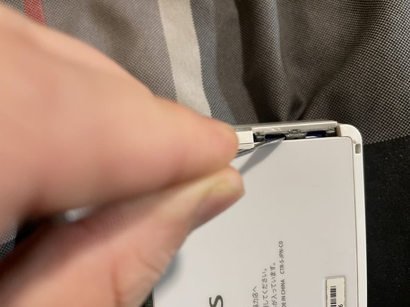

A Jammed SD Card Tray
  1. A Jammed SD Card Tray, A Jammed SD Card Tray: crwdns2935265:01crwdnd2935265:01crwdnd2935265:02crwdne2935265:0 A Jammed SD Card Tray, A Jammed SD Card Tray: crwdns2935265:01crwdnd2935265:02crwdnd2935265:02crwdne2935265:0
    • As you see the sd tray is bent in.
    • And you can’t get it open like usual.

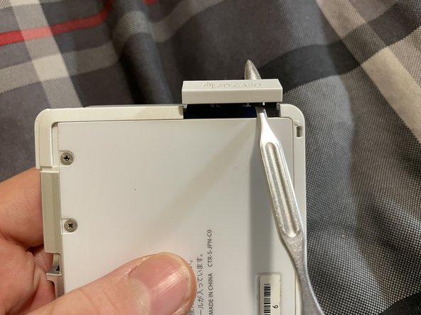

  2. A Jammed SD Card Tray, Popping up tray: crwdns2935265:02crwdnd2935265:01crwdnd2935265:02crwdne2935265:0 A Jammed SD Card Tray, Popping up tray: crwdns2935265:02crwdnd2935265:02crwdnd2935265:02crwdne2935265:0
    • Pop up the sd port tray
  3. A Jammed SD Card Tray, Popping open tray: crwdns2935265:03crwdnd2935265:01crwdnd2935265:03crwdne2935265:0 A Jammed SD Card Tray, Popping open tray: crwdns2935265:03crwdnd2935265:02crwdnd2935265:03crwdne2935265:0 A Jammed SD Card Tray, Popping open tray: crwdns2935265:03crwdnd2935265:03crwdnd2935265:03crwdne2935265:0
    • Here is the tool you need or something similar
    • PLEASE BE CAREFUL IT CAN DAMAGE THE EXPOSED MOTHERBOARD INSIDE IF NOT

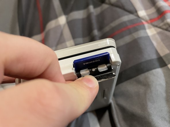

  4. A Jammed SD Card Tray, Remove sd card: crwdns2935265:04crwdnd2935265:01crwdnd2935265:03crwdne2935265:0 A Jammed SD Card Tray, Remove sd card: crwdns2935265:04crwdnd2935265:02crwdnd2935265:03crwdne2935265:0 A Jammed SD Card Tray, Remove sd card: crwdns2935265:04crwdnd2935265:03crwdnd2935265:03crwdne2935265:0
    • You have to press down on sd like the physical game to get it out
    • And don’t forget to close the tray

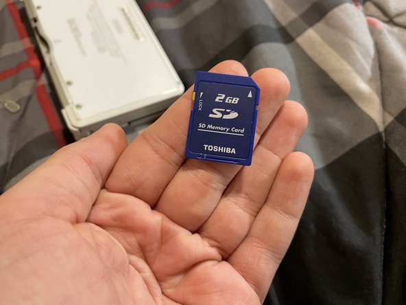

Thanks and you’re welcome now you have free access to your sd card!
