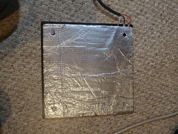

    • Take the 3mm Heated Bed and the foam insulation. Partially peel the backing paper on one corner of the insulation
    • Center the foam insulation on the back of the bed. Once it's centered press down on the corner were you peeled the backing paper from.
  3. 9. Bed, Foam Insulation: crwdns2935265:03crwdnd2935265:01crwdnd2935265:02crwdne2935265:0 9. Bed, Foam Insulation: crwdns2935265:03crwdnd2935265:02crwdnd2935265:02crwdne2935265:0
    • Peel more of the backing paper off but do not let the foam touch the bed yet.
    • Starting in the corner that is already taped to the bed go in a diagonal direction towards the opposite corner pressing the foam down to the bed
    • Expose more of the backing paper and repeat until the insulation is taped to the underside of the bed

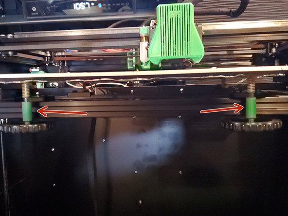

  4. 9. Bed, Heated Bed Mounting: crwdns2935265:04crwdnd2935265:01crwdnd2935265:03crwdne2935265:0 9. Bed, Heated Bed Mounting: crwdns2935265:04crwdnd2935265:02crwdnd2935265:03crwdne2935265:0 9. Bed, Heated Bed Mounting: crwdns2935265:04crwdnd2935265:03crwdnd2935265:03crwdne2935265:0
    • Using the 4x M4x55 countersunk screws, bed springs, and bed adjustment wheels mount the bed to the frame.
    • The bed wires should face the back panel
    • With the new bed adjustment wheels they won't work with the metal kit. I made some spacers so you can still use them. You can find them on my Github
    • Mount the bed frame to the Z brackets with 4x M5x10 button head screws and 4x M5 T-nuts
    • Feed the bed wires through the hole on the bottom left of the back panel

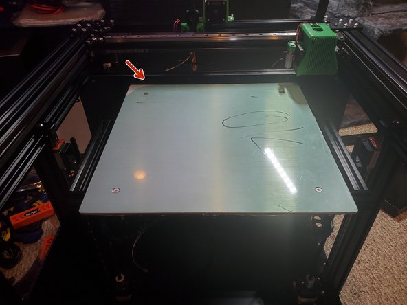

  5. 9. Bed, Bed Plate: crwdns2935265:05crwdnd2935265:01crwdnd2935265:01crwdne2935265:0
    • Peel the protective film off the bed. It would be wise to use IPA to clean the bed.
    • Peel the backing paper off the glass bed surface.
    • Press the glass bed surface onto the heated bed.
