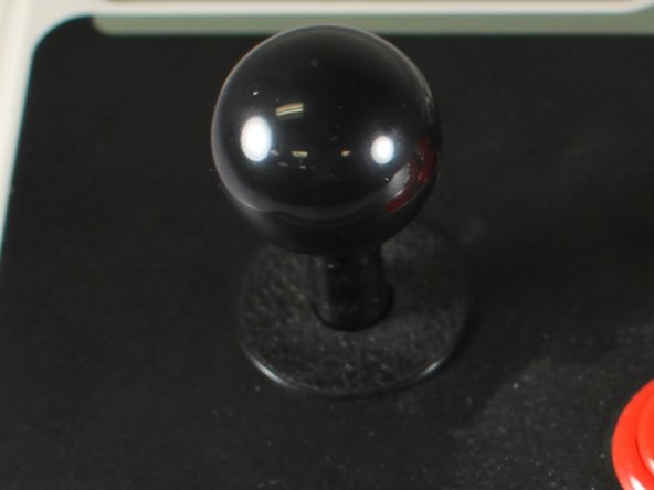

8Bitdo N30 Joystick Replacement
  1. 8Bitdo N30 Joystick Replacement, Joystick: crwdns2935265:01crwdnd2935265:01crwdnd2935265:02crwdne2935265:0 8Bitdo N30 Joystick Replacement, Joystick: crwdns2935265:01crwdnd2935265:02crwdnd2935265:02crwdne2935265:0
    • Turn the device over so that the bottom of the device is facing up.
  2. 8Bitdo N30 Joystick Replacement: crwdns2935265:02crwdnd2935265:01crwdnd2935265:01crwdne2935265:0
    • Use a Phillips #0 screwdriver to remove all ten of the 3 mm screws on the back plate.
