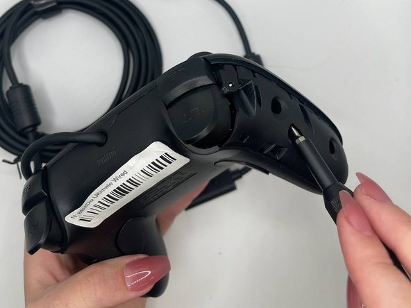

    • Orient the controller such that the back of the controller is facing you.
    • Insert an opening tool into the small opening on the back of the grip, and gently pry the grip cover away until it pops free.

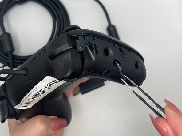

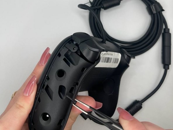

    • Use the TR6 Torx Security screwdriver to remove the top left 10.44 mm screw on the backside.
    • Use tweezers to help you remove the screw if it does not come out with the driver.

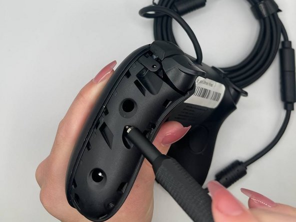

  4. 8BitDo Ultimate Wired Vibration/Rumble Motor Replacement: crwdns2935265:04crwdnd2935265:01crwdnd2935265:03crwdne2935265:0 8BitDo Ultimate Wired Vibration/Rumble Motor Replacement: crwdns2935265:04crwdnd2935265:02crwdnd2935265:03crwdne2935265:0 8BitDo Ultimate Wired Vibration/Rumble Motor Replacement: crwdns2935265:04crwdnd2935265:03crwdnd2935265:03crwdne2935265:0
    • Use the TR6 Torx Security screwdriver to remove the middle left 10.44 mm Torx screw on the backside.

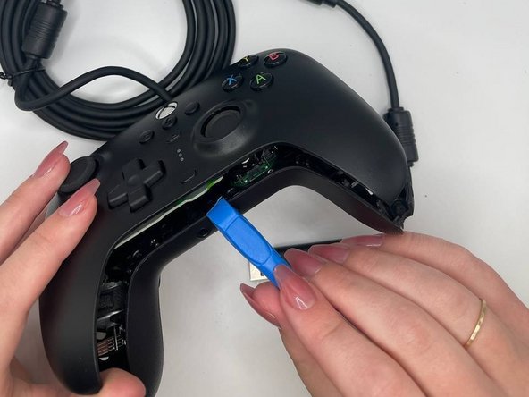

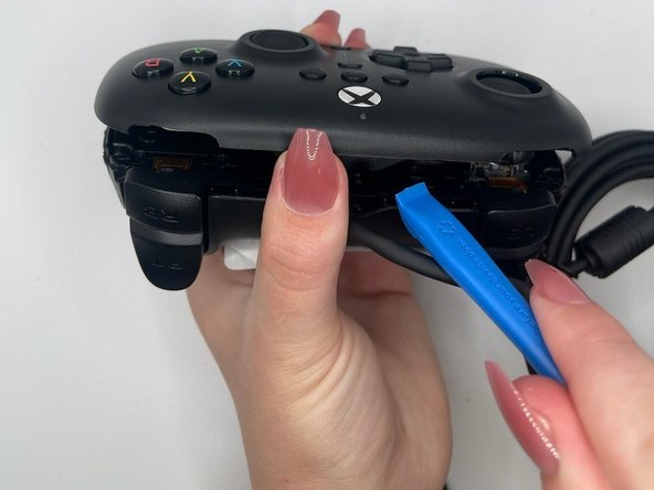

    • Insert an opening tool into the small opening between the front and back panels, and gently pry the back panel away to open the bottom clamps of the top panel of the controller.
  10. 8BitDo Ultimate Wired Vibration/Rumble Motor Replacement: crwdns2935265:010crwdnd2935265:01crwdnd2935265:02crwdne2935265:0 8BitDo Ultimate Wired Vibration/Rumble Motor Replacement: crwdns2935265:010crwdnd2935265:02crwdnd2935265:02crwdne2935265:0
    • Insert an opening tool into the small opening between the front and back panel (top view) and pry away to remove the top half.

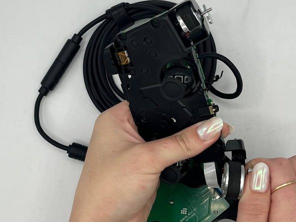

  11. 8BitDo Ultimate Wired Vibration/Rumble Motor Replacement: crwdns2935265:011crwdnd2935265:01crwdnd2935265:03crwdne2935265:0 8BitDo Ultimate Wired Vibration/Rumble Motor Replacement: crwdns2935265:011crwdnd2935265:02crwdnd2935265:03crwdne2935265:0 8BitDo Ultimate Wired Vibration/Rumble Motor Replacement: crwdns2935265:011crwdnd2935265:03crwdnd2935265:03crwdne2935265:0
    • Pull the midframe free with an adequate amount of force.

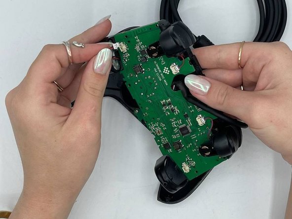

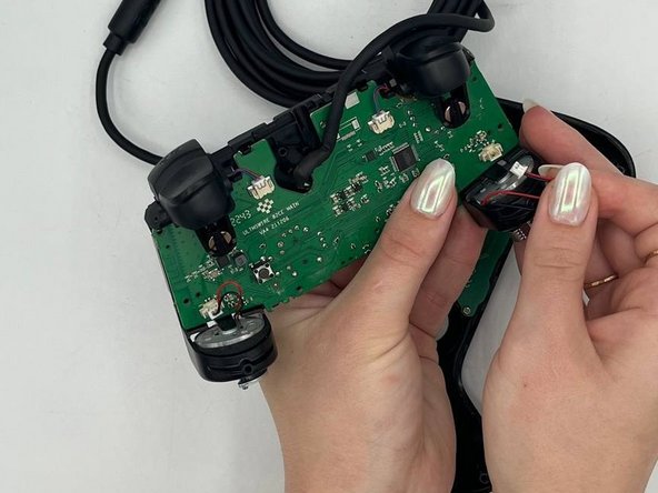

  12. 8BitDo Ultimate Wired Vibration/Rumble Motor Replacement: crwdns2935265:012crwdnd2935265:01crwdnd2935265:03crwdne2935265:0 8BitDo Ultimate Wired Vibration/Rumble Motor Replacement: crwdns2935265:012crwdnd2935265:02crwdnd2935265:03crwdne2935265:0 8BitDo Ultimate Wired Vibration/Rumble Motor Replacement: crwdns2935265:012crwdnd2935265:03crwdnd2935265:03crwdne2935265:0
    • Detach the motor connector from the motherboard.

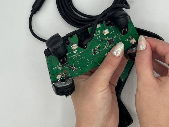

  13. 8BitDo Ultimate Wired Vibration/Rumble Motor Replacement: crwdns2935265:013crwdnd2935265:01crwdnd2935265:02crwdne2935265:0 8BitDo Ultimate Wired Vibration/Rumble Motor Replacement: crwdns2935265:013crwdnd2935265:02crwdnd2935265:02crwdne2935265:0
    • Pull the weight out of the housing with adequate force.

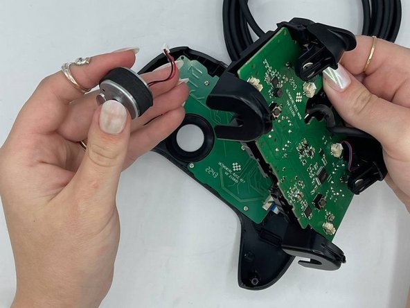

  14. 8BitDo Ultimate Wired Vibration/Rumble Motor Replacement: crwdns2935265:014crwdnd2935265:01crwdnd2935265:03crwdne2935265:0 8BitDo Ultimate Wired Vibration/Rumble Motor Replacement: crwdns2935265:014crwdnd2935265:02crwdnd2935265:03crwdne2935265:0 8BitDo Ultimate Wired Vibration/Rumble Motor Replacement: crwdns2935265:014crwdnd2935265:03crwdnd2935265:03crwdne2935265:0
    • Remove the rumble or vibration motor from the controller.
