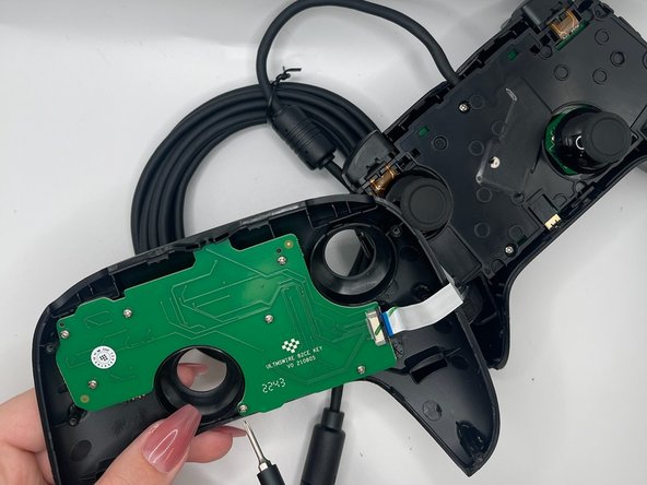

  11. 8BitDo Ultimate Wired Buttons Replacement: crwdns2935265:011crwdnd2935265:01crwdnd2935265:03crwdne2935265:0 8BitDo Ultimate Wired Buttons Replacement: crwdns2935265:011crwdnd2935265:02crwdnd2935265:03crwdne2935265:0 8BitDo Ultimate Wired Buttons Replacement: crwdns2935265:011crwdnd2935265:03crwdnd2935265:03crwdne2935265:0
    • Use the Phillips #0 Screwdriver to remove all seven 6.14 mm Phillips screws from the button PCB.
  12. 8BitDo Ultimate Wired Buttons Replacement: crwdns2935265:012crwdnd2935265:01crwdnd2935265:03crwdne2935265:0 8BitDo Ultimate Wired Buttons Replacement: crwdns2935265:012crwdnd2935265:02crwdnd2935265:03crwdne2935265:0 8BitDo Ultimate Wired Buttons Replacement: crwdns2935265:012crwdnd2935265:03crwdnd2935265:03crwdne2935265:0
    • Remove the button PCB.
    • Pinch the silicone cover on the buttons to remove it, such that the buttons are exposed.
  13. 8BitDo Ultimate Wired Buttons Replacement: crwdns2935265:013crwdnd2935265:01crwdnd2935265:03crwdne2935265:0 8BitDo Ultimate Wired Buttons Replacement: crwdns2935265:013crwdnd2935265:02crwdnd2935265:03crwdne2935265:0 8BitDo Ultimate Wired Buttons Replacement: crwdns2935265:013crwdnd2935265:03crwdnd2935265:03crwdne2935265:0
    • Simply using the force from your finger, push the button out of the housing.
    • Pull button out.
