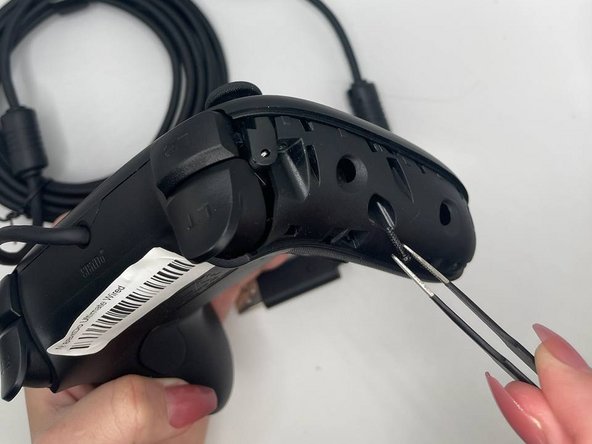

    • Orient the controller such that the back of the controller is facing you.
    • Insert an opening tool into the small opening on the back of the grip, and gently pry the grip cover away until it pops free.

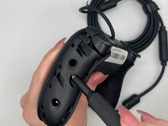

  3. 8BitDo Ultimate Wired Bumper Replacement: crwdns2935265:03crwdnd2935265:01crwdnd2935265:03crwdne2935265:0 8BitDo Ultimate Wired Bumper Replacement: crwdns2935265:03crwdnd2935265:02crwdnd2935265:03crwdne2935265:0 8BitDo Ultimate Wired Bumper Replacement: crwdns2935265:03crwdnd2935265:03crwdnd2935265:03crwdne2935265:0

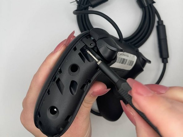

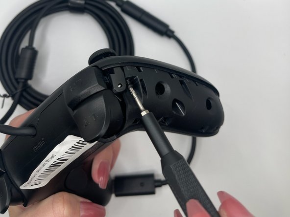

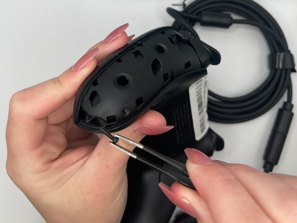

    • Use the TR6 Torx Security screwdriver to remove the top left 10.44 mm torx screw on the backside.
    • Use tweezers to help remove the screws (optional).

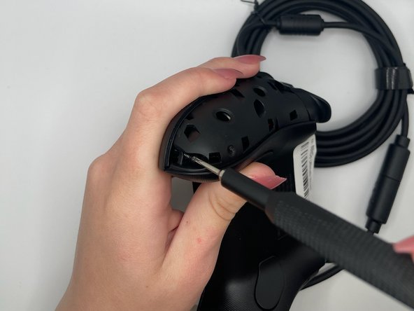

  4. 8BitDo Ultimate Wired Bumper Replacement: crwdns2935265:04crwdnd2935265:01crwdnd2935265:03crwdne2935265:0 8BitDo Ultimate Wired Bumper Replacement: crwdns2935265:04crwdnd2935265:02crwdnd2935265:03crwdne2935265:0 8BitDo Ultimate Wired Bumper Replacement: crwdns2935265:04crwdnd2935265:03crwdnd2935265:03crwdne2935265:0

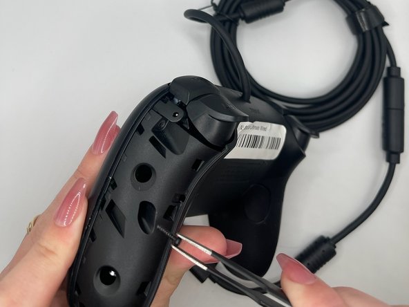

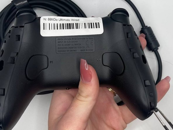

    • Use the TR6 Torx Security screwdriver to remove the middle left 10.44 mm Torx screw on the backside.

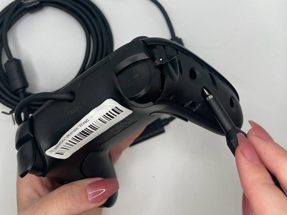

  5. 8BitDo Ultimate Wired Bumper Replacement: crwdns2935265:05crwdnd2935265:01crwdnd2935265:03crwdne2935265:0 8BitDo Ultimate Wired Bumper Replacement: crwdns2935265:05crwdnd2935265:02crwdnd2935265:03crwdne2935265:0 8BitDo Ultimate Wired Bumper Replacement: crwdns2935265:05crwdnd2935265:03crwdnd2935265:03crwdne2935265:0

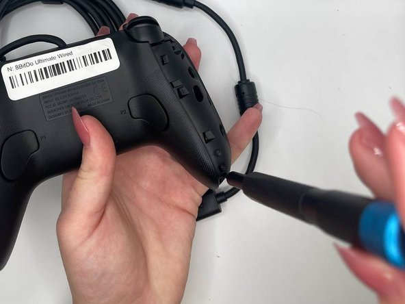

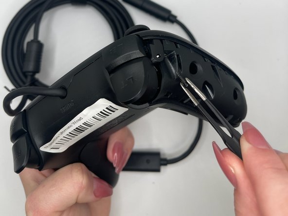

    • Use the TR6 Torx Security screwdriver to remove the bottom left 10.44 mm Torx screw on the backside.

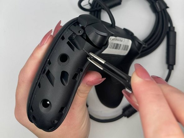

    • Use the TR6 Torx Security screwdriver to remove the top right 10.44 mm Torx screw on the backside.

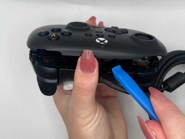

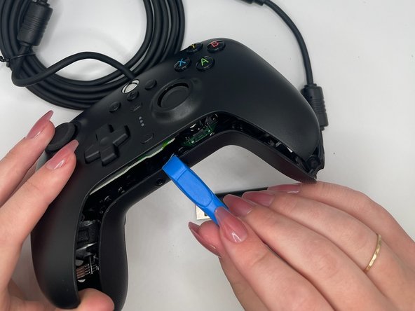

    • Insert an opening tool into the small opening between the front and back panels, and gently pry the back panel away to open the bottom clamps of the top panel of the controller.
  10. 8BitDo Ultimate Wired Bumper Replacement: crwdns2935265:010crwdnd2935265:01crwdnd2935265:02crwdne2935265:0 8BitDo Ultimate Wired Bumper Replacement: crwdns2935265:010crwdnd2935265:02crwdnd2935265:02crwdne2935265:0
    • Insert an opening tool into the small opening between the front and back panel (top view) and pry away to remove the top half.

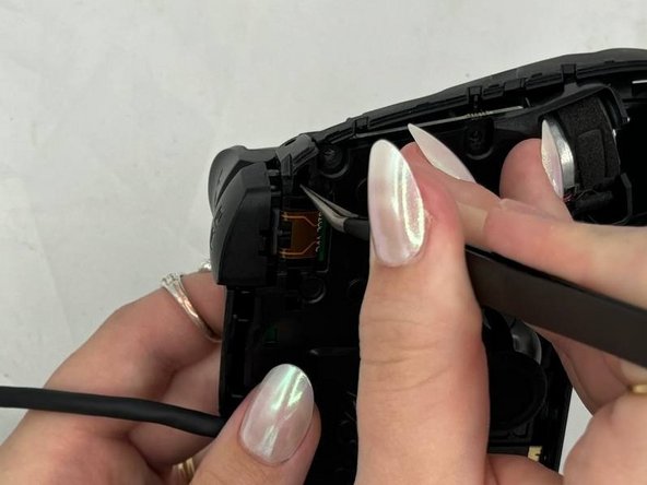

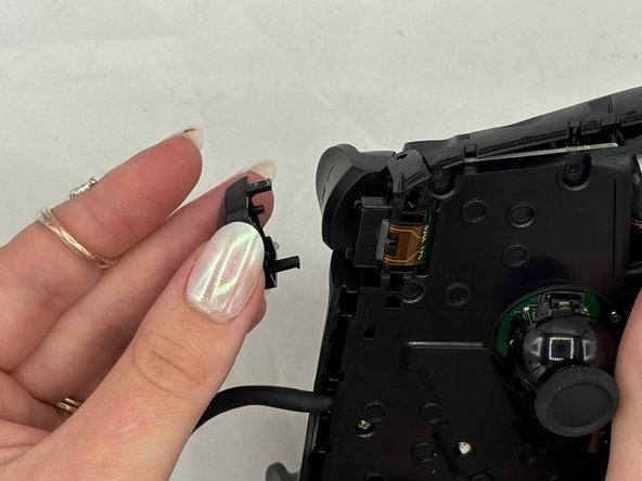

    • Orient the controller such that the back is facing you.
    • Use tweezers to help pull out the black piece on the top right side.
    • Simply pull out the loosened piece with the force of your hand.
